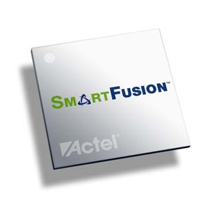

Actel Corporation unveiled SmartFusion, the world's first intelligent mixed signal FPGA. Available in production quantities, SmartFusion devices feature Actel's proven FPGA fabric, a complete microcontroller subsystem built around a hard ARM Cortex-M3 processor and programmable analog blocks on a flash process. Embedded designers no longer have to compromise. Now, they can easily build the system they want, with all the features they need, on a single chip.

The combination of three programmable elements--logic, a microcontroller subsystem and analog--makes the SmartFusion family a fully-customizable, easy-to-use system design platform. Embedded designers can now optimize hardware / software tradeoffs on the fly without board-level changes. In the SmartFusion device, all the data transferred from the processor to the FPGA or from the analog to the processor or between the FPGA and the analog is on-chip. In addition, Actel's FlashLock technology provides a superior level of intellectual property (IP) security.
When faced with options for co-processing or interface customization, SmartFusion devices offer a compelling solution in a wide variety of applications, including motor control, system and power management and industrial automation. These applications span the industrial, military, medical, telecommunications, computing and storage markets.
"SmartFusion is the innovative, intelligent integration of the key components of a system," said John East, Actel's president and CEO. "Due to Actel's flash technology, we now offer the industry's first and only no-compromise, fully programmable platform for embedded design."

SmartFusion devices feature Actel's proven, flash-based ProASIC3 FPGA architecture. Built on an advanced 130-nm CMOS process, Actel offers densities ranging from 60K to 500K system gates, with 350 MHz performance and up to 204 I/Os. This combination enables the integration of existing functions from other devices, substantially reducing board space and power consumption of the overall system.
Microcontroller Subsystem:
Intelligence is added to the FPGA in the form of a microcontroller subsystem that features a hard ARM Cortex-M3 processor running at 100 MHz. A full complement of standard peripherals and features include:
- Multi-layer AHB communications matrix with up to 16 Gbps throughput
- 10/100 Ethernet MAC with RMII interface
- Two of each: SPI, I2C, UART, 32-bit timers
- Up to 512 KB flash memory and 64 KB of SRAM
- External memory controller (EMC)
- 8-channel DMA controller
Programmable Analog:
The innovative and proprietary Analog Compute Engine (ACE) performs sample sequencing and computation, which offloads the ARM Cortex-M3 processor from analog initialization and processing. The programmable analog system features:
- ADCs and DACs with 1 percent accuracy
- Up to three 12-bit ADC with up to 600 Ksps sampling rate
- Up to three 12-bit first order sigma delta DACs
- Up to ten 50 ns high-speed comparators
- Multiple integrated temperature, voltage and current monitors
