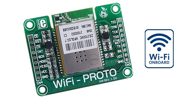

MikroElektronika pleasure to announce a new WiFi - PROTO Board. Tool features ZeroG ZG2100M module that provides extremely fast data rates that are supported with a wide data range. Board is ideal for use in embedded applications and OEM equipment that require wireless 2.4GHz 802.11b.
MikroElektronika WiFi-PROTO
The WiFi - PROTO Board is miniature, inexpensively priced wireless 2.4GHz 802.11b Module, ideal for use in embedded applications and OEM equipment. On-board module ZeroG ZG2100M module provides extremely fast data rates that are supported with a wide data range. A communication protocols that are available to interface to your control system or microcontroller are standard UART and SPI communication.
