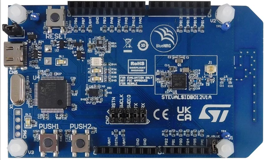

The STEVAL-IDB012V1 tool is available to support evaluation and development for the BlueNRG-LPS.
Evaluation platform based on the BlueNRG-LPS system-on-chip
Evaluation platform based on the BlueNRG-LPS system-on-chip.
