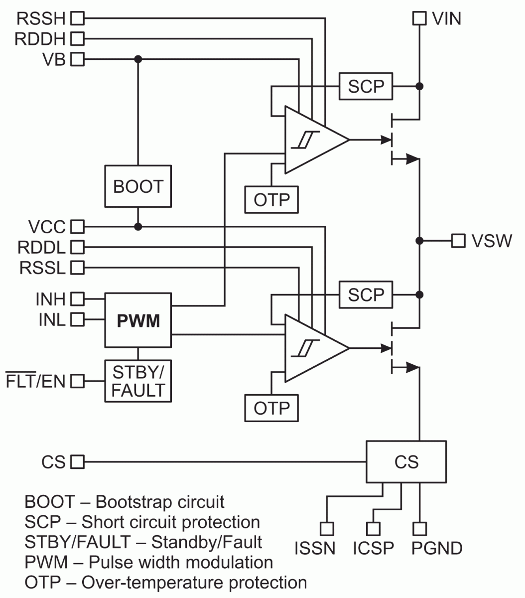

The NV6257 simplified schematic
The NV6257 simplified schematic.
