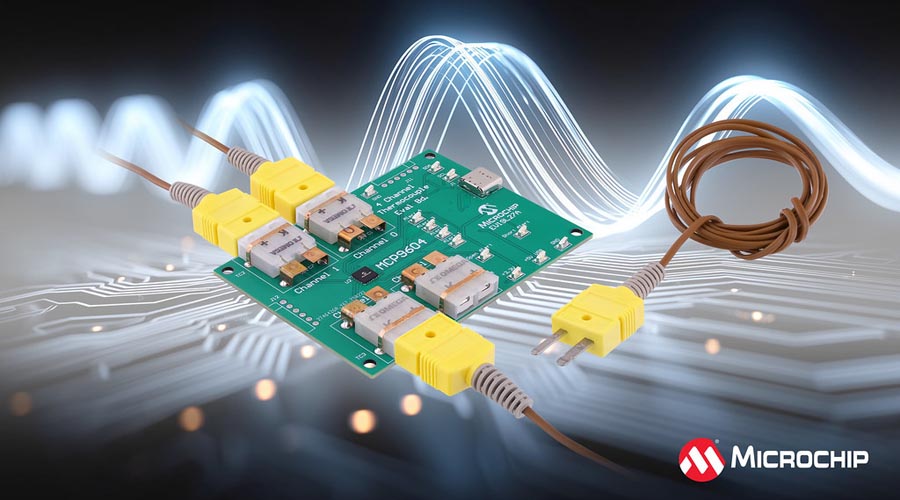

The MCP9604 device is supported by the Microchip EV19L27A evaluation board. It can connect to and read information from as many as four thermocouples and includes a microcontroller that acts as a host system for receiving this information and plotting the selected thermocouple. The evaluation board also includes free software that can be downloaded from either the MCP9604 or EVB web pages.
The EV19L27A evaluation board
The EV19L27A evaluation board.
