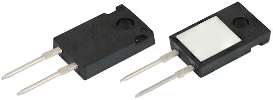

To meet the growing demand for high performance electronic components in next-generation automotive applications, Vishay Intertechnology introduced a new AEC-Q200 qualified, 50 W thick film power resistor in a compact TO-220 package for direct mounting on a heatsink.
Vishay - LTA 50
Engineered to ensure exceptional reliability and durability in even the most extreme automotive environments, the Vishay Sfernice LTA 50 withstands high humidity conditions and temperatures to +175 °C, while providing a high tolerance against vibration and electrical stress. This guarantees consistent performance in safety-critical applications.
Offering a broad range of resistance values from 0.010 Ω to 450 kΩ, with tolerances down to ±1%, the device released serves as the precharge or discharge resistor for on-board chargers, battery management systems (BMS), and motor controls for electric vehicles (EV), hybrid electric vehicles (HEV), and plugged hybrid electric vehicles (PHEV). The RoHS-compliant device offers a non-inductive design, with a high dielectric strength of 1500 Vrms and limiting element voltage of 500 V.
