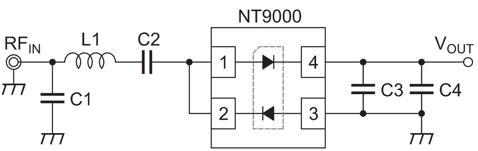

Example of a 5.7 GHz voltage doubler circuit using the NT9000
Example of a 5.7 GHz voltage doubler circuit using the NT9000.

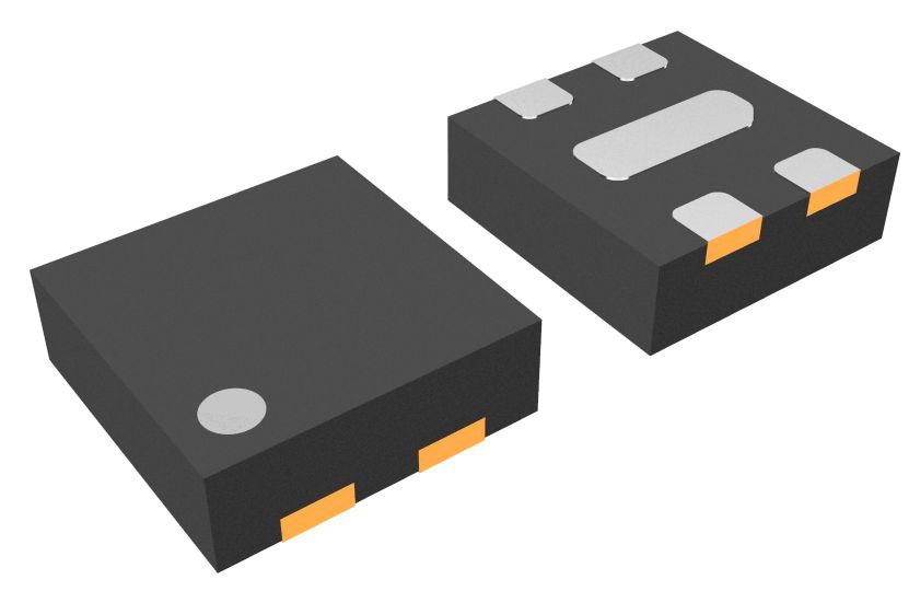

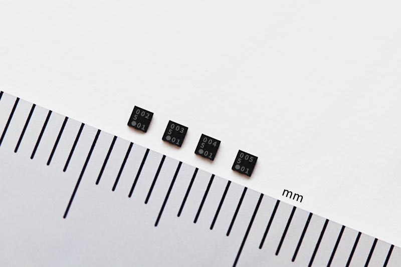

2. Small package
These products use a small, 1.2 × 1.2 mm DFN package. Each product integrates two diodes into a single package. This contributes to a reduction in the mounting area.
