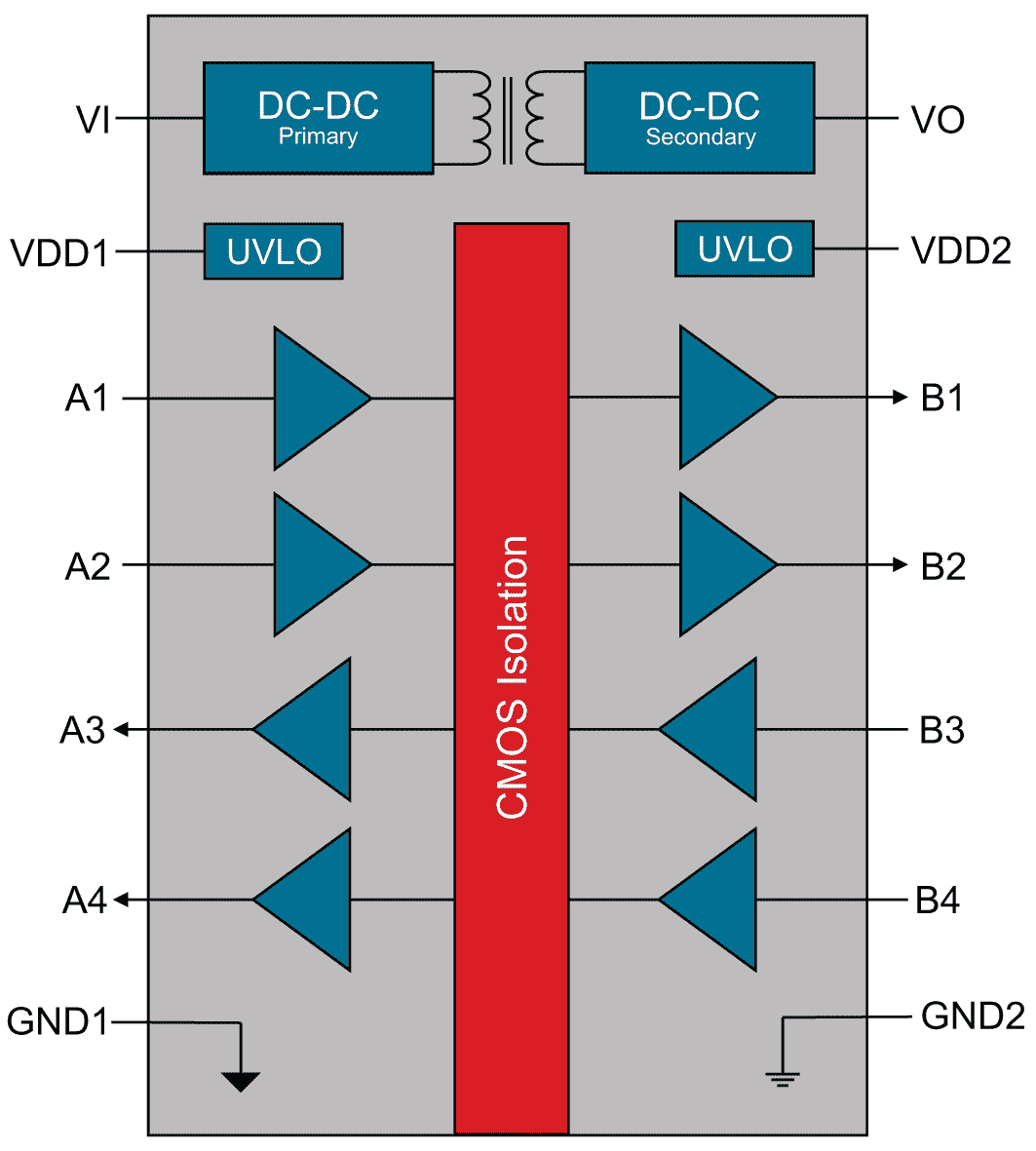

The Si86Px addresses a critical challenge for system designers: generating high-quality isolated power in applications where board space is limited or where no power source is readily available on the isolated side. By integrating signal and power isolation into a single package, the Si86Px can help reduce time to market while providing a well-regulated power source for sensitive components such as ADCs and sensors.
Integrated isolation for power and data
The Si86Px family integrates Skyworks’ digital isolator technology with an isolated dc-dc converter capable of delivering up to 0.5 W of isolated power. This approach eliminates the need for bulky external transformers and power modules, enabling more compact and cost-effective system designs.
Skyworks - Si86Px
