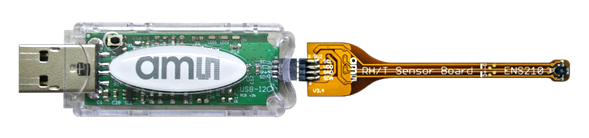

Evaluation Kit for ENS210
Evaluation Kit for ENS210.

An evaluation board for the ENS210 is available from the ams ICdirect online store.
