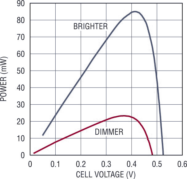

To extract maximum power from the PV cell, the input resistance of the power converter must be matched to the output resistance of the cell, resulting in operation at the maximum power point. Figure 3 shows the power curve for a typical single photovoltaic cell. To ensure maximum power extraction, the output voltage of the PV cell should be operated at the peak of the power curve. The LTC3105 adjusts the output current delivered to the load in order to maintain the PV cell voltage at the voltage set by the maximum power point control pin. Therefore, a single programming resistor establishes the maximum power point and ensures maximum power extraction from the PV cell and peak output charging current.
Typical photovoltaic cell power curve
Figure 3. Typical photovoltaic cell power curve.
