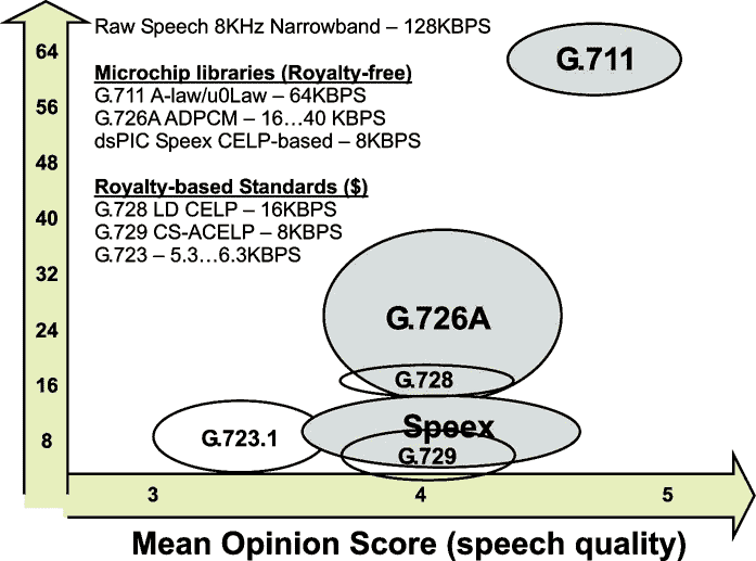

Since memory space (and transmission bandwidth) is usually at a premium in an embedded system, digital compression is applied to the data stream, either throwing away part of the information it contains or using a more complex coding algorithm to represent it in a more compact manner. Compression/decompression can be done using either an external codec or a software codec running on the MCU itself. Figure 1 illustrates the quality/data rate trade-offs involved compressing a standard 128-kbit/s audio stream with the most commonly-used ITU (G.7xx) algorithms as well as the Speex¹ open-source codec.

Figure 1. Bit rate vs. audio quality for commonly used speech codecs. (Courtesy of Microchip Technology.)
The amount of processing power (MIPS) a particular codec requires varies in rough proportion to the compression ratio and quality of the audio it delivers, as illustrated in Table 2. Fortunately, even inexpensive 16-bit general-purpose MCUs can easily support simple software codecs used for speech processing, such as adaptive differential pulse code modulation (ADPCM) or the simpler G.7xx ITU standards. The G.711 algorithm requires approximately 1 MIPS to process moderate quality human speech at a 2:1 compression ratio. The G.722 wideband algorithm delivers better audio quality and a 4:1 compression ratio while consuming only 5 MIPS. Both codecs can be comfortably supported on 16-bit MCUs, such as Freescale’s HC12 series, Microchip’s PIC24F /PIC24H families, or TI’s extensive line of MSP430 MCUs, with enough reserve for supervisory code or other applications. In addition to the usual telephony and VoIP applications, these inexpensive techniques can make use of the surplus MIPS lurking within many embedded systems to add audio alerts (or even speech synthesis) to smoke detectors, alarm systems, or exercise and industrial equipment.

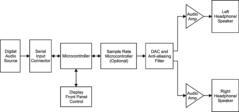

Nevertheless, low-cost MCUs can still play a big role in consumer audio, usually by managing the digital music streams in audio accessories, such as docking stations and digital speaker sets (Figure 2). In these applications, a frame of PCM audio data (encapsulated in the USB audio class format) arrives every 1 ms via one of the processor’s SPI/I²C serial channels. The USB audio class data format also provides controls for common features such as volume, tone, gain control, and equalizers.

Figure 2. In an audio docking station, a low-cost MCU can be used to perform format conversion, sample rate adaptation, and stream management, as well as support the dock’s user interface. (Courtesy of Microchip Technology.)
Depending on the source, the audio stream may arrive in one of several formats (i.e., left-justified, right-justified, I2S, etc.) and some lower-cost codecs can only accept a specific format. In these cases, the MCU must make sure the data is properly aligned before it is fed to the codec. Since not all audio sources use the same sampling rate, the codec must adapt its sampling frequency to the source or rely on the MCU to convert the sampled data stream into a common data rate. In these cases where a lower-cost codec is employed, it usually lacks its own buffer, so the MCU must also manage the stream to avoid under- or over-run conditions that would otherwise cause silences, pops, and audio discontinuities that occur with data loss.
Some 16-bit MCUs, and nearly any 32-bit MCU, that deliver 40 MIPS or more have the processing capacity to support the stream management, buffering, and format conversion that takes place in an audio dock. Some manufacturers like Microchip have added special features which can cut implementation costs. For example, some MCUs in Microchip’s MX2 family have memories specifically sized for these types of applications and have an I²C ref clock output. This allows the MCU to supply a sample rate clock (master clock) that eliminates the need for a more expensive codec with an integrated or external PLL.

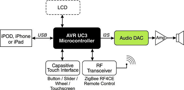

Figure 3. Atmel’s versatile AT32UC3 family can be used as the basis for an audio docking station, a decoder/playback system for MP3, WMA and AAC audio, or as a USB Audio-Class device. (Courtesy of Atmel.)

Atmel also supplies several application-specific development kits, including the EVK1104 which contains all the elements for Hi-Fi audio decoding and streaming applications (Figure 5). Built around Atmel’s AT32UC3A3256AU 32-bit microcontroller, the board includes a high-speed USB On-The-Go (OTG) interface, a dual SD card interface, ECC NAND flash, and a stereo 16-bit DAC. The kit also contains reference firmware for playing MP3 files from mass-storage devices, and demonstrates Atmel's patented QTouch capacitive-touch control. For docking stations, Atmel’s EVK1105 contains all required reference hardware and software for control and digital audio streaming from iPod, iPhone, and iPad devices.
