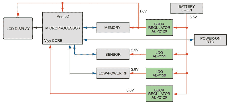

Smartphones, tablets, digital cameras, navigation systems, medical equipment, and other low-power portable devices often contain multiple integrated circuits manufactured on different semiconductor processes. These devices typically require several independent supply voltages, each usually different than the voltage supplied by the battery or external ac-to-dc power supply.
Figure 1 shows a typical low-power system operating with a Li-Ion battery. The battery’s usable output varies from 3 V to 4.2V, while the ICs require 0.8 V, 1.8 V, 2.5 V, and 2.8 V. A simple way to reduce the battery voltage to a lower dc voltage is to use a lowdropout regulator (LDO). Unfortunately, power not delivered to the load is lost as heat, making LDOs inefficient when VIN is much greater than VOUT. A popular alternative, the switching converter, alternately stores energy in an inductor’s magnetic field, and releases the energy to the load at a different voltage. Its reduced losses make it a better choice for high efficiency. Buck, or step-down converters – covered here – provide lower voltage. Boost, or step-up converters – to be covered in a future article – provide higher output voltage. Switching converters that include internal FETs as switches are called switching regulators, while devices requiring external FETs are called switching controllers. Most low-power systems use both LDOs and switching converters to achieve cost and performance objectives.
Typical low-power portable system
Figure 1. Typical low-power portable system.

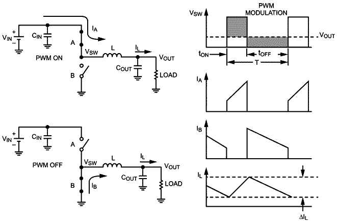

Buck regulators consist of two switches, two capacitors, and an inductor, as shown in Figure 2. Nonoverlapping switch drives ensure that only one switch is on at a time to avoid unwanted current “shoot through.” In Phase 1, Switch B is open, and Switch A is closed. The inductor is connected to VIN, so current flows from VIN to the load. The current increases due to the positive voltage across the inductor. In Phase 2, Switch A is open and Switch B is closed. The inductor is connected to ground, so current flows from ground to the load. The current decreases due to the negative voltage across the inductor, and energy stored in the inductor is discharged into the load.
Buck converter topology and operating waveforms
Figure 2. Buck converter topology and operating waveforms.
Note that the switching regulator operation can be continuous or discontinuous. When operating in continuous conduction mode (CCM), the inductor current never drops to zero; when operating in discontinuous conduction mode (DCM), the inductor current can drop to zero. Low-power buck converters rarely operate in DCM. The current ripple, shown as ΔIL in Figure 2, is typically designed to be 20% to 50% of the nominal load current.
