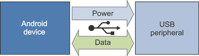

USB interactions between an Android device and the USB peripheral or accessory have to follow the USB specification. USB is a host-centric protocol, meaning that the host initiates all transactions and that there can be only one host on the bus. A USB host, then, must be present among the connected devices. Thus, an Android device can interface with a USB-based device in two different ways: in USB host mode(the connected USB device is called a USB peripheral) and USB accessory mode (the connected USB device is called an Android USB accessory).
In USB host mode, the Android device acts as the USB host, powers the USB bus, and enumerates the USB peripherals connected to it. The Android device typically connects to peripherals like keyboards, mice, and game controllers in USB host mode (Fig. 1).
Develop AOA USB Accessories For Android-Based Systems
Figure 1. An Android device operates in USB host mode when connecting to a peripheral.
Running Android devices in USB host mode while providing a current of up to 500 mA to power the USB peripheral can drain the device’s battery, especially if the USB peripheral is power-heavy. Power-heavy peripherals include medical and diagnostic equipment, exercise equipment, docking stations, portable point of sale (POS) devices, and car panels with Android connectivity, among many others.
In addition, some Android devices do not have the USB host hardware needed to support communications in USB host mode. The Android device generally has a specific list of USB devices it can support called the target peripheral list (TPL). In such cases, devices that aren’t on the TPL need to communicate in an alternate way.

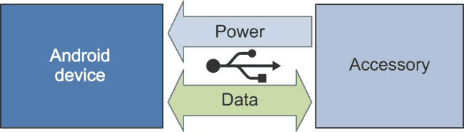

USB accessory mode overcomes the limitations of USB host mode by having the external USB accessory act as the USB host. The accessory powers the USB bus and communicates with the Android device (Fig. 2).
Figure 2. An Android device can also operate in USB accessory mode.
Android devices that can’t act as a USB host then can interact with the USB accessory. Such accessories generally have large batteries or a wired power connection.

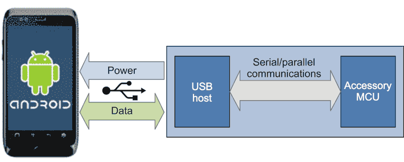

Figure 3. A typical implementation while expanding to Android support would
require us to add a USB host to the existing accessory and establish
a communication interface between it and the accessory MCU.
The first step would be to evaluate the resources available in the accessory MCU. The two things that primarily need to be accounted for are memory and the communication block. Sufficient memory, either RAM or flash, is required to implement code to interface and control the host IC and to implement the AOA Protocol stack. The communication block can include SPI/UART/I2C or I/O pins.
A communication protocol like SPI/UART/I2C is required to establish communication with the USB host IC. For this, the system needs either an available hardware communication block, or, if unavailable, the communication protocol stack must be implemented in software; i.e., also known as “bit-banging” mode. The I/O pins chosen should be compatible with the protocol required to communicate with the host IC.
For instance, if one intends to implement a software SPI master on the peripheral microcontroller, then it should be possible that the I/O pin chosen as the SPI_Clock can be driven at the required clock rate, as determined by the throughput requirement. Similarly, an available hardware SPI master on the accessory MCU will give us the flexibility of interfacing a SPI slave (USB host controller) on the topology. In this case, one extra general-purpose I/O (GPIO) might be needed for interrupt requests from the host IC and one GPIO for Slave_Select of the SPI slave. If there are other SPI slaves in the system, the same master out slave in (MOSI), SPI_Clock, and master in slave out (MISO) can be used.
The next step is to choose the right USB host IC to match the MCU resources to ensure optimal accessory performance. There are three primary considerations: the type of IC (programmable or fixed function), the communication interface of the host IC, and the desired throughput.
The most basic type of USB host ICs are the serial interface engine (SIE) ICs, which give the accessory MCU complete control over the USB communication. The MCU controls every packet data on the USB bus. Such an implementation consumes more code memory on the accessory MCU, which is not advisable when there is a constraint on MCU memory resources.
Other host ICs with in-built MCUs can be programmed to function as desired while controlling USB packet data. Such host controllers ease the load on the accessory MCU, saving both RAM and offloading processing from the MCU. Host ICs will implement the whole host firmware stack within the host, leaving the accessory MCU to simply perform data exchanges and send custom control commands to communicate with the Android device.
For example, one can program the host IC to send a Get_Descriptor request on receiving a specific code from the accessory MCU over SPI. Such host ICs can send data to the accessory MCU as any other slave on the SPI bus. One can also use such host ICs in standalone mode for a new design of accessory, i.e., without an external MCU to control it.
