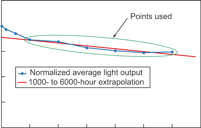

TM-21 Details
The new document specifies precisely how to extrapolate the LM-80-08 lumen maintenance data (Fig. 2). Here’s how it works:
  • For each unit in the data set, the measured light output at the start of is normalized to a value of “1.”
  • At each point where light output is measured, the normalized data for all units is averaged. (In other words, the results depict the average behavior of the whole set of units.)
  • All data from the start of the test to 1000 hours is discarded.
  • If the test stops at 6000 hours, the average lumen maintenance data points from 1000 hours to 6000 hours are fit to a simple exponential extrapolation model using a least-squares curve fit.
  • If the test runs for 6000 to 10,000 hours, only the last 5000 hours of data are used for the extrapolation.
  • For tests that run more than 10,000 hours, the data points from the last 50% of the total measurement time are used. However, if the last 50% of the total measurement time is not an integer multiple of 1000 hours, take more than 50% until the data comes out to an integral multiple of 1000 hours. The “times-six” rule is intended to limit the length of lumen maintenance predictions.
Do LEDs Have A Dark Side?
Figure 2. The extrapolation process described in IES TM-21-11, “Projecting Long Term Lumen Maintenance of LED Light Sources,” provides a bridge from LM-80 test results to predictions of lumen maintenance.
If that description is too concise to really understand, don’t worry. In January, the EPA made available the Energy Star TM-21 calculator. [4] Its availability makes it possible for users to request LM-80 data sets from LED vendors and interpolate (for example) from test values at 55 °C and 85 °C to obtain lumen depreciation values for 75 °C.

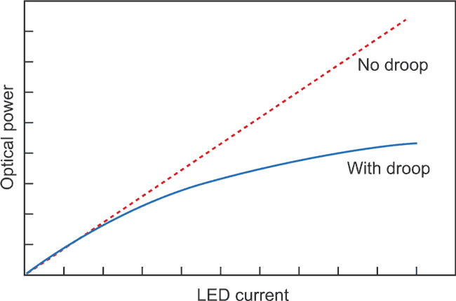

Droop
“Droop” refers to the phenomenon in LEDs where more current produces more lumens of output only up to a point, beyond which lumen output no longer increases linearly with increasing current (Fig. 3). This phenomenon in LEDs has always been hard to explain.
Figure 3. With conventional LEDs, light output does not increase linearly with current. Something happens with the recombination of election-hole pairs that normally results in the emission of a photon. A phenomenon called auger scattering, in which an electron is generated instead of a photon, is presently considered the best candidate for an explanation. This is leading at least one company to pursue GaN-on-GaN as a possible solution.
The quantum process by which the generation and recombination of electron-hole pairs causes photon emission doesn’t behave nicely. Beyond a certain current, the recombinations apparently produce another electron, instead of a photon.
Semiconductor physicists who deal with LEDs have been chasing several suspect processes because knowing which one it is could provide a handle for dealing with droop. The prime candidate today is Auger scattering, named after Pierre Victor Auger, a twentieth century French physicist.
