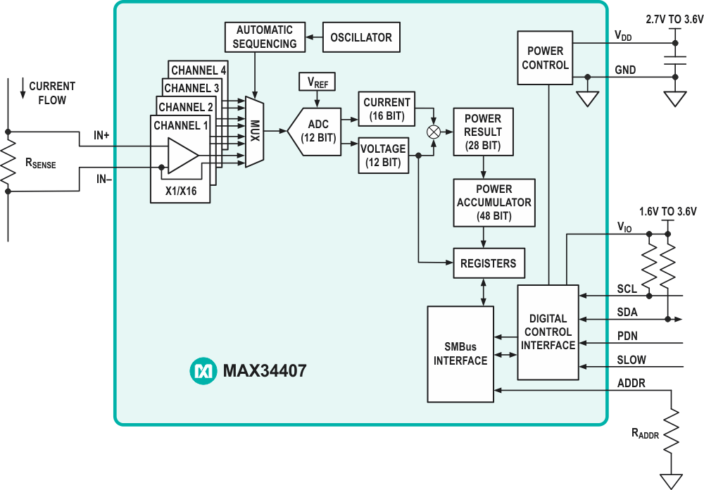

Power accumulators measure voltage and current samples, multiply them to get a power reading, and add multiple readings to get an accumulated power value. Accumulated power and sample count information is stored on-chip.
As an example, see the MAX34407 block diagram shown in Figure 1. MAX34407 automatically collects current and voltage samples from four channels using a multiplexer, current-sense amplifier, and 12-bit ADC. The voltage and current samples are multiplied on-chip to obtain a 28-bit power value for each sample pair. The power values are added and stored in a 48-bit register, and the count of instantaneous power samples accumulated is stored in a 24-bit register. The use of an automatic sequencer and integrated oscillator make the MAX34407 fully autonomous, as it does not require an external sample clock.
| Figure 1. | MAX34407 Power Accumulator Block Diagram. | |
Upon an I2C/SMBus command from the host, the device transfers the accumulated power samples and count to a set of registers available to the host. This transfer occurs without missing a sample and allows the host to retrieve data at any time interval. In normal mode, the MAX34407 samples at a rate of 1,024 sps. Since the accumulation depth is 48 bits while individual samples are 28 bits, 220 samples can be stored before the host controller needs to read back the data:

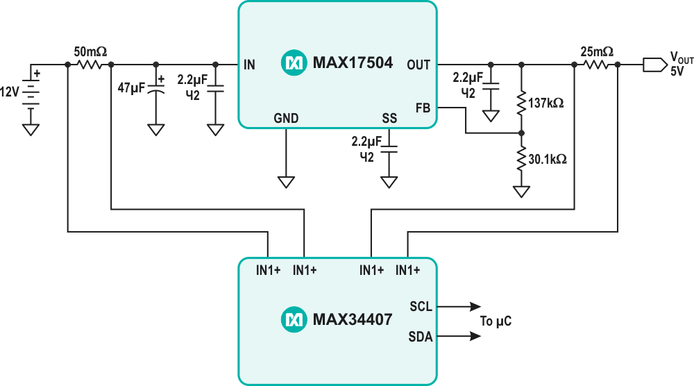

Since the MAX34407 accumulates power on multiple rails, efficiency can be measured by accumulating power at the input (PIN) and output (POUT) of a converter. The result of these two measurements may be sent to a microprocessor for efficiency computation using the following formula:
Figure 2 demonstrates a typical circuit for measuring efficiency of the MAXM17504 step-down converter using the MAX34407 power accumulator. An example application for this circuit is a 12 V solar panel system where the primary converter typically incorporates a maximum power point tracking (MPPT) algorithm. Real-time efficiency measurements provide feedback of MPPT algorithm performance. This allows the system or designer to optimize the MPPT algorithm based on in-circuit measurements. MAXM17504 input voltage range is 12 V ±10%, which fits into MAX34407 common-mode voltage range of +2.7 V to +15 V. The full-scale range of the current-sense amplifier is 100 mV, so a 50 mΩ resistor was used on the input for 2 A maximum input current and a 25 mΩ resistor was used on the output for 4 A maximum output current.
| Figure 2. | Efficiency Measurement Application Circuit. | |

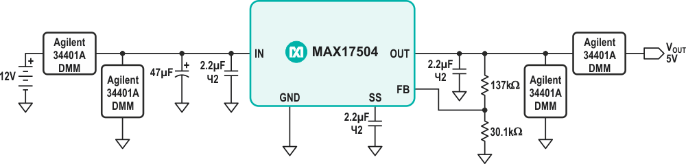

| Figure 3. | Efficiency Measurement Circuit using 4 DMMs. | |
In Figure 3, the efficiency measurement circuit using 4-DMMs demonstrates an alternative method for measuring efficiency using four benchtop digital multi-meters (DMM). The 4-DMM method measures input current, output current, input voltage, and output voltage to obtain a highly accurate efficiency measurement. The 4-DMM method is used as a baseline measurement for comparison with the efficiency measurement obtained from the power accumulator IC. An efficiency comparison between MAX34407 and the four DMM efficiency measurement methods is shown in Figure 4.

The notable offset in the two methods is attributed to the power dissipated in the output current sense resistor. This value is included in the input power measurement but not in the output power measurement, since MAX34407 measures the common-mode load voltage from the lower voltage terminal of the sense resistor. Measured output power may be compensated by adding the calculated sense resistor power dissipation, which yields the total output power. The equations used to compensate the efficiency measurements are shown below, where Pout and VOUT are measured by MAX34407 and RSENSE is a known value. The results of the compensated efficiency measurement are shown in Figure 5.
The results of Figure 5 demonstrate a maximum difference of –0.5% between the 4-DMM and MAX34407 efficiency measurements. This shows the MAX34407 can be used to accurately measure in-system efficiency of a switching converter with proper output power compensation. It is important to note that the compensation technique works best for converters with a ripple voltage of 1% or less.
