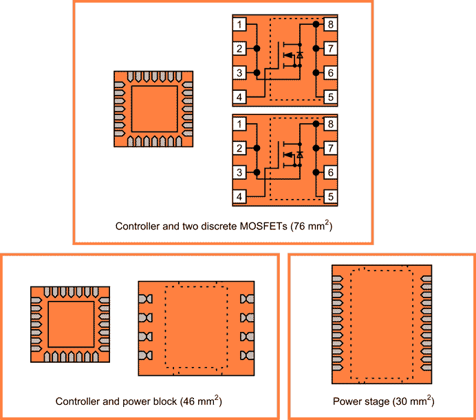

Essentially, reducing the size of a power supply will lead to better power density (see Figure 1).
By combining the controller and power FETs into a single three-dimensional package, designers can save onboard space. In this example, the board real-estate savings is 60%.
Figure 1. By combining the controller and power FETs into a single three-dimensional package, designers can save
onboard space. In this example, the board real-estate savings is 60%. (Source: Texas Instruments).
