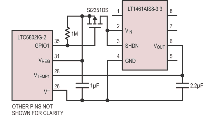

In applications designed to monitor real-world characteristics, accuracy depends on the ability to perform measurements against a known voltage reference. A stable reference voltage is essential in sensor systems for accurate data conversion by ADCs, or for energy storage designs requiring careful control of voltage needed to optimize lithium-ion cell operation. Designers can combine the Linear Technology LTC6802 Li-ion battery monitor with the Linear LT1461 voltage reference to deliver highly-accurate Li-ion cell charge management (Figure 1).
Series Voltage References Refine Accuracy in Power-Limited Energy-Harvesting Designs
Figure 1. Voltage references provide high accuracy needed for applications such as those depending on accurate charge management needed for Li-ion energy storage (Courtesy of Linear Technology).

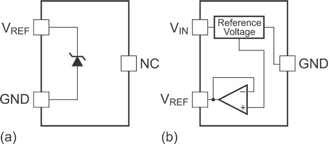

Voltage reference ICs are available across a wide range of performance options, but their fundamental characteristics derive from their basic topology as shunt references or series references (Figure 2).
Figure 2. Shunt references (a) are typically two-terminal devices that resemble Zener diodes in operation, while series references (b) are typically three-terminal devices that more closely resemble low-dropout (LDO) regulators (Courtesy of Texas Instruments).
Shunt references are two-terminal devices that offer the advantages of simple design and good stability across a wide range of operating conditions. Although they resemble a Zener diode in operation, they are typically available as buried Zener or bandgap devices. Shunt references use an external resistor to set current, allowing them to be used with high supply voltages and configured as negative voltage or floating references in designs. On the other hand, these devices shunt unused current to ground, resulting in wasted energy in low-load conditions.
Series references
In contrast, power consumption in series references is limited to load current and their own quiescent-current needs, making them ideal for energy-harvesting applications with tight power budgets. Series voltage references with ultra-low-power requirements offer a further advantage in overall system stability. Typically, voltage references require a significant turn-on time needed for the output voltage to stabilize at the required reference level. Devices that operate with a sufficiently-low quiescent current allow engineers to leave them powered continuously, ensuring the highest possible accuracy and minimal latency for sensor applications. A stable, always-on voltage reference eliminates the chance of dead time in data conversion, cell monitoring, or other critical measurement applications when a more power-hungry voltage reference IC might need to be powered down to conserve power in energy-limited applications.

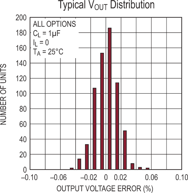

Linear Technology quotes an initial accuracy of 0.05 percent for its LT6656 precision voltage reference. At the same time, the company notes that like all devices in this class, individual parts will show normal variation about a mean, requiring engineers to account for individual part differences for high-precision applications (Figure 3).
Figure 3. Performance characteristics for individual voltage reference ICs will depart from idealized datasheet specifications due to manufacturing and physical variation (Courtesy of Linear Technology).

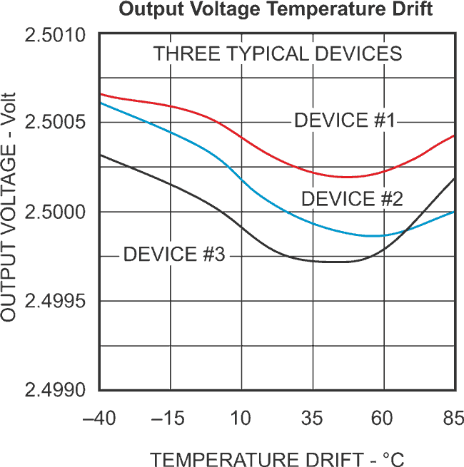

Low temperature drift is important for consistent results across changing thermal conditions, and devices in this class typically boast low drift characteristics. The Touchstone Semiconductor TS6001 combines 27 µA current requirements and initial output voltage accuracy of less than 0.08 percent with a low-output-voltage temperature coefficient of 7 ppm/°C that remains largely uniform across individual parts (Figure 4).
Figure 4. Precision voltage reference ICs feature low temperature drift that remains largely consistent across different units (Courtesy of Touchstone Semiconductor).
