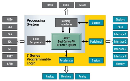

One of the great advantages of the ARM ecosystem is that silicon vendors can take the best ARM IP and combine it with their own expertise to offer board suppliers unique capabilities. A perfect example of this is the Xilinx Zynq, which combines a dual core ARM Cortex-A9 processor with programmable FPGA fabric. Dave Tokic of Xilinx says that this approach gives designers tremendous flexibility in the way they approach a project – they can use the Cortex-A9 to run the system, and use the FPGA fabric for highly compute-intensive functions like video processing in a single device. The block diagram for the Zynq is shown below.
It's not just Raspberry Pi
Avnet offers the Zynq-based ZedBoard (along with a lively online community) for as little as $249, which is an incredibly low entry point into the world of FPGAs.

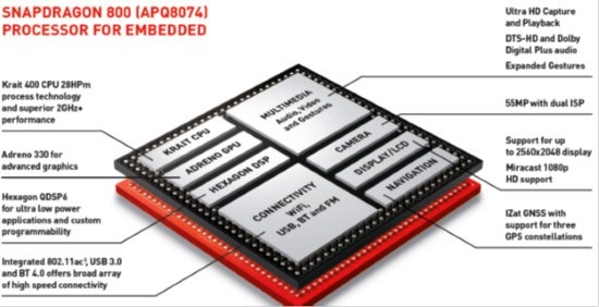

Qualcomm is well known for communications innovation, so you would expect an embedded processor from it to be replete with comms options, and their Snapdragon doesn't disappoint. The latest Qualcomm Snapdragon (810) is a 64-bit octa-core processor (4x ARM Cortex-A57 and 4x ARM Cortex-A53) with Wi-Fi, Bluetooth, and GPS, so whatever the system designer needs to connect to there are many ways to get there. The Snapdragon processor (block diagram below) is appearing in May on new boards from Canada's Intrinsyc at a $495 price point (SOMs should sell for less).
