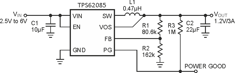

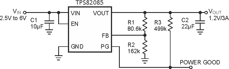

Figure 1. Typical schematics of both a discrete power supply (a) and power
module (b) for a 1.2-V output voltage are very simple.
Figure 1 shows the typical schematic for an example step-down converter, which is available as either a discrete integrated circuit (IC) or MicroSiP1 power module. Both solutions deliver 3 A of output current to this example’s 1.2-V rail. The passive components required are identical for each device except for the inductor, which is integrated into the module. Both devices use the DCS-Control topology2, which gives excellent transient response and good output-voltage regulation; both are required in communications equipment and storage applications.

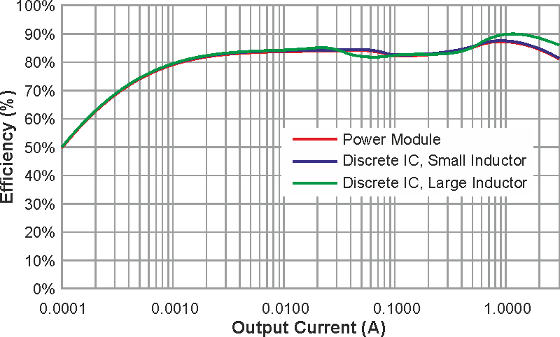

Figure 2 shows the efficiency of the discrete power supply and power module with the inductor used in their respective datasheet’s measurements. A larger inductor is used for the discrete IC and a smaller inductor for the power module. A third curve shows the efficiency of the discrete power supply with the same, smaller inductor incorporated in the power module.
Power Module or Discrete Power Solution: What's Best for Your Design?
Figure 2. The efficiency of a discrete power supply (TPS62085) and power module
(TPS82085) for a 1.2-V output voltage is nearly identical until the arrival
of heavier load currents.
As expected, the discrete power supply with the smaller inductor gives the same efficiency as the power module. The efficiency is essentially the same between all three options until higher load currents. At these currents, the DCR difference of the inductors is most significant and responsible for the efficiency change.
