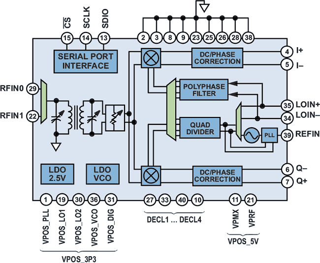

The ADRF6820 quadrature demodulator and synthesizer, shown in Figure 1, is ideally suited for next-generation communication systems. The feature-rich device comprises a high-linearity broadband I/Q demodulator, an integrated fractional-N PLL, and a low-phase-noise multicore VCO. It also integrates a 2:1 RF switch, a tunable RF balun, a programmable RF attenuator, and two LDOs. The highly integrated RFIC is available in a 6-mm × 6-mm LFCSP package.
| Figure 1. | ADRF6820 simplified block diagram. |

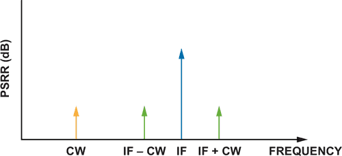

Ideally, only the desired RF and LO signals are presented to the mixer core, but this is rarely the case. Power-supply noise can couple into the mixer inputs and manifest itself as mixing spurs. Depending on the source of the noise coupling, the relative amplitudes of the mixing spurs may vary. Figure 3 shows a sample mixer output spectrum and where the mixing products may reside due to power-supply-noise coupling. In the figure, CW corresponds to a continuous wave or sinusoidal signal that couples on to the power-supply rail. The noise may be the clock noise from a 600-kHz or 1.2-MHz switching regulator, for example. The power-supply noise can cause two different problems – if the noise couples to the mixer outputs, the CW tone will appear at the output with no frequency translation; if the coupling occurs at the mixer inputs, the CW tone will modulate the RF and LO signals, producing products at IF ± CW.
| Figure 3. | Sample mixer output spectrum with power-supply noise coupling. |
These mixing products can be close to the desired IF signal, so filtering them out becomes difficult, and dynamic range loss is inevitable. This is especially true for quadrature demodulators because their baseband is complex and centered around dc. The demodulation bandwidth of the ADRF6820 spans from dc to 600 MHz. If a switching regulator with noise at 1.2 MHz powers the mixer core, undesired mixing products will occur at IF ± 1.2 MHz.

The major functional blocks of the ADRF6820 each have their own power pins. Two domains are powered from the 5-V supply. VPMX powers the mixer core, and VPRF powers the RF front-end and input switches. The remaining domains are powered from the 3.3-V supply. VPOS_DIG powers an integrated LDO, which outputs 2.5 V to power the SPI interface, the PLL’s Σ-Δ modulator, and the synthesizer’s FRAC/INT dividers. VPOS_PLL powers the PLL circuitry, including the reference input frequency (REFIN), phase-frequency detector (PFD), and the charge pump (CP). VPOS_LO1 and VPOS_LO2 power the LO path, including the baseband amplifier and dc bias reference. VPOS_VCO powers another integrated LDO, which outputs 2.8 V to power the multicore VCO. This LDO is important for minimizing the sensitivity to power-supply noise.

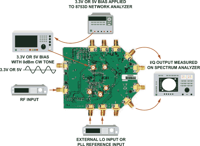

Figure 4 shows the lab setup. Apply a 3.3-V or 5-V dc source to the network analyzer to produce a swept continuous sinusoidal signal with a 3.3-V or 5-V offset. Apply this signal to each of the power rails on the RFIC. Two signal generators provide the RF and LO input signals. Measure the output on a spectrum analyzer.
| Figure 4. | ADRF6820 PSRR measurement setup. |

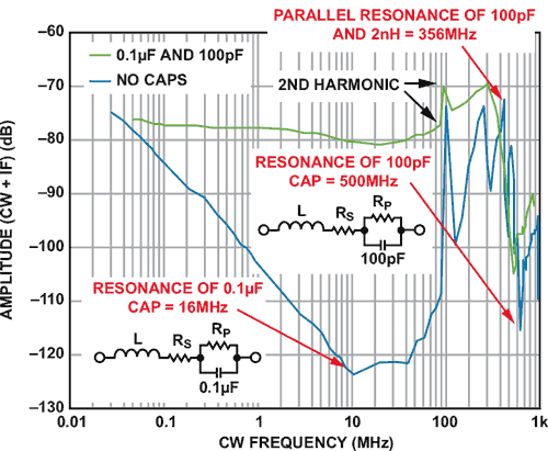

The amplitude of the undesired mixing products depends on the chip’s power-supply rejection, and the size and location of the decoupling capacitors on the evaluation board. Figure 5 shows the amplitude of the (IF + CW) tone at the output given a 0-dB sinusoidal signal on the power pin. With no decoupling capacitors, the amplitude of the undesired tone was between –70 dBc and –80 dBc. The data sheet recommends a 100-pF capacitor adjacent to the device on top of the board and a 0.1-µF capacitor on the back. The resonance of these external decoupling capacitors can be seen in the graph. The transition at 16 MHz is due to the resonance of the 0.1 µF capacitor with a 1-nH parasitic inductance. The transition at 356 MHz is due to the resonance of the 100-pF capacitor with 2 nH of parasitic inductance from both capacitors. The transition at 500 MHz is due to the resonance of the 100-pF capacitor with a 1-nH parasitic inductance.
| Figure 5. | Effects of decoupling capacitor resonance on IF ± CW. |

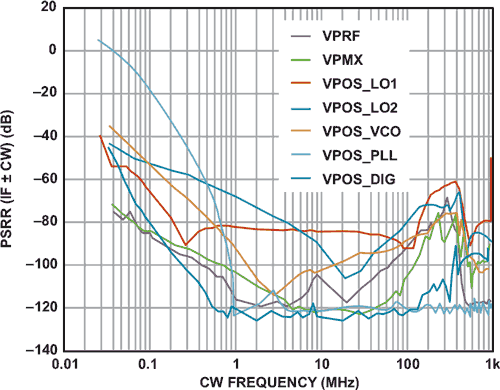

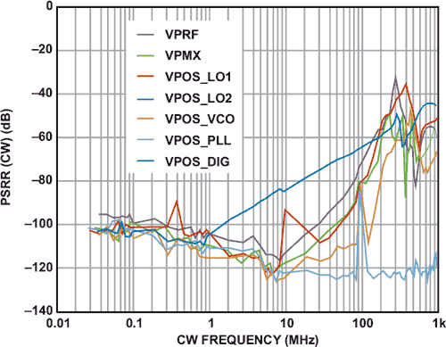

The amplitudes of the interfering signal (CW) on the power-supply rail and the modulated signals (IF ± CW) were measured at the baseband outputs. Noise was introduced to the power rail under test, while the other power supplies remained clean. Figure 6 shows the amplitude of the (IF ± CW) tone when a 0-dB sinusoidal signal was injected on the power pin and swept from 30 kHz to 1 GHz. Figure 7 shows the feedthrough from the CW tone to the baseband outputs.
| Figure 6. | PSRR of the (IF ± CW) tone. |
| Figure 7. | PSRR of the CW tone. |
