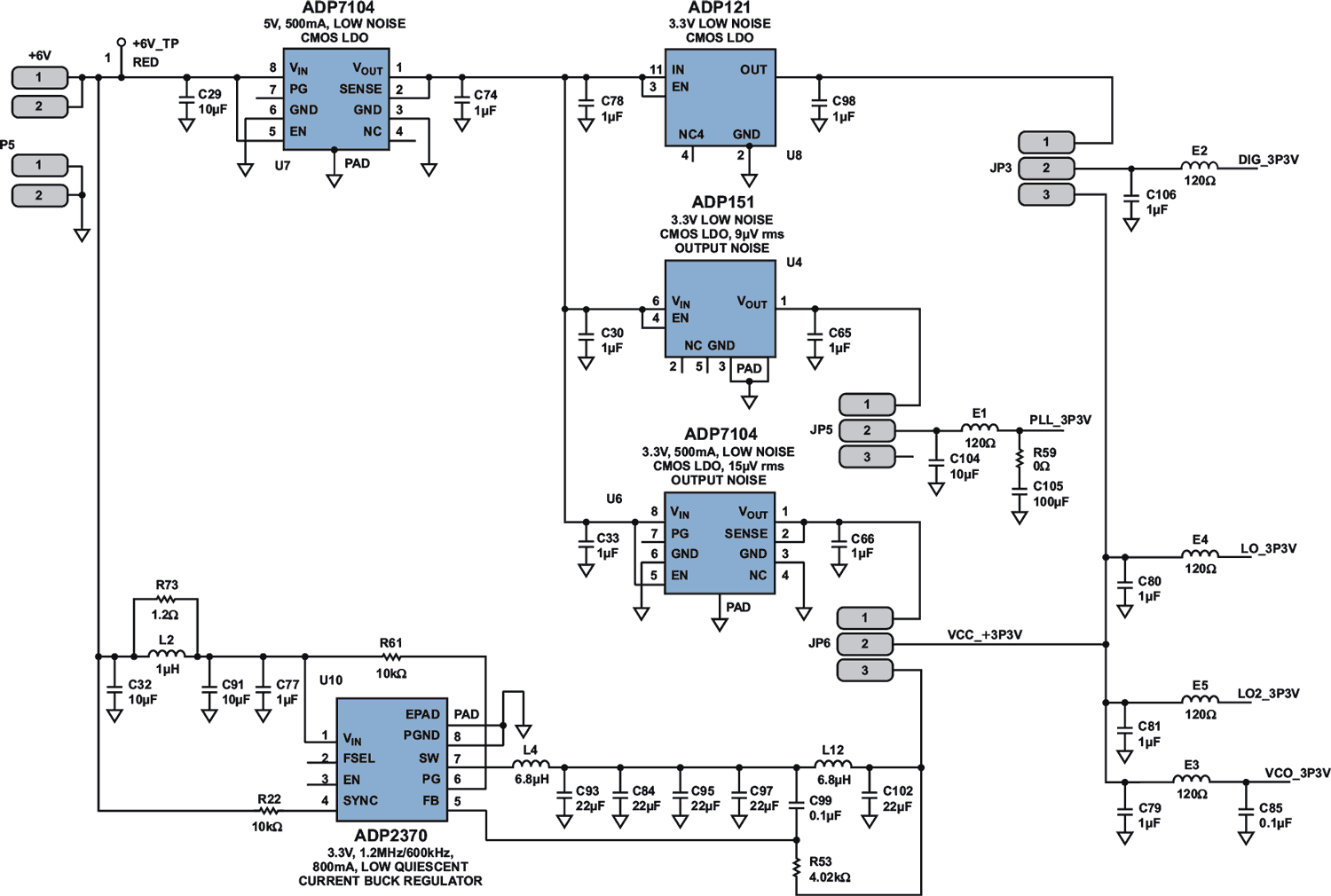

With a good understanding of the maximum power consumption of the ADRF6820 in its various modes and the sensitivity of each power domain, power-management solutions were designed using both switching regulators and LDOs to determine the feasibility of both power solutions. First, a 6-V source was regulated to 5 V and 3.3 V for the ADRF6820 power rails. Figure 9 shows the power design for the 5-V power-supply for VPMX and VPRF. The ADP7104 CMOS LDO can deliver up to 500 mA load current. The ADP2370 low quiescent current step-down (buck) switching regulator can operate at 1.2 MHz or 600 kHz. Additional filtering was added to the switching regulator output to attenuate the switching noise. The ADP2370 can deliver up to 800 mA load current. The ADRF6820’s 5-V rail can be sourced by either the ADP7104 or the ADP2370. Additional decoupling and filtering is applied to each power pin.
Figure 10 shows the 3.3-V power design. The source voltage is still 6.0 V, but an additional LDO steps the source down to an intermediate voltage before it further gets regulated down to 3.3 V. The extra stage is required to reduce power loss, as a 6-V source regulated directly down to 3.3-V would operate at 55% maximum efficiency. An intermediate stage is not necessary for the switching regulator path because its pulse-width modulation (PWM) architecture minimizes power loss.
| Figure 9. | 5-V power design. |
The 3.3-V design allowed for more experimentation. In addition to sourcing the 3.3-V rail with either an LDO or a switching regulator, the VPOS_PLL rail has additional LDO options and the VPOS_DIG rail has an optional isolated LDO. As the PLL power-supply is the most sensitive, three power solutions were tried, each with different output noise: the ADP151 3.3-V ultralow-noise CMOS LDO with 9 µV rms output noise; the ADP7104 3.3-V low-noise CMOS LDO with 15 µV rms output noise; and the ADP2370 3.3-V buck regulator. We want to determine the highest level of power-supply noise that will still maintain the required phase-noise performance. Is the highest performance, lowest noise LDO an absolute necessity?
The ADP121 3.3-V low-noise CMOS LDO was also tried on the VPOS_DIG power rail to determine if digital noise would affect performance. The digital power rail tends to be noisier than the analog supplies due to switching on the SPI interface. We want to determine if the digital 3.3-V power-supply will require its own LDO or if it can be coupled directly to the analog power-supply. The ADP121 was chosen as a low-cost solution.

| Figure 10. | 3.3-V power design. |

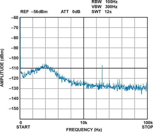

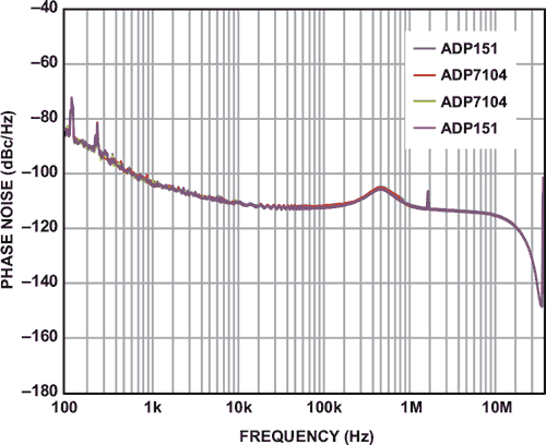

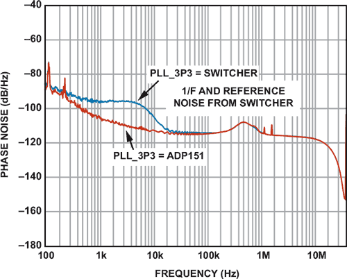

For VPOS_PLL, the most sensitive power-supply rail, the low-cost ADP151 LDO achieves the same phase noise as the ADP7104 high-performance, low-noise LDO, as shown in Figure 11. Performance was degraded when the ADP2370 switching regulator was used, however, as shown in Figure 12. The noise hump is caused by the switching regulator, and can be seen on its output, as shown in Figure 13. Thus, VPOS_PLL can tolerate up to 15 µV rms noise with no degradation in integrated phase noise, but a switching regulator cannot be used to power this pin. No benefit is obtained by using a higher performance, lower noise LDO.
| Figure 11. | Integrated phase noise using the ADP151 and ADP7104. |
| Figure 12. | Integrated phase noise using the ADP151 and ADP2370. |

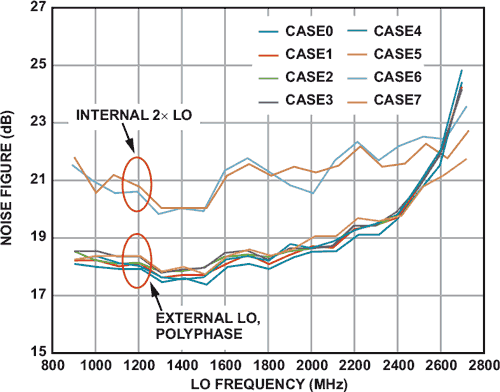

Good phase-noise performance is maintained when either a switching regulator or an LDO powers the remaining supply rails, as shown in Figure 14. The 5-V power-supply pins, VMPX and VPRF, can both be tied together and sourced with a single supply. The 3.3-V power-supply pins, VPOS_LO1, VPOS_LO2, and VPOS_VCO, can also be tied together and sourced by a single supply. VPOS_DIG does not require an independent LDO and can be tied to the analog 3.3-V power-supply.
| Figure 13. | Output spectrum of the ADP2370. |
| Figure 14. | Switcher vs. LDO noise figure. |
