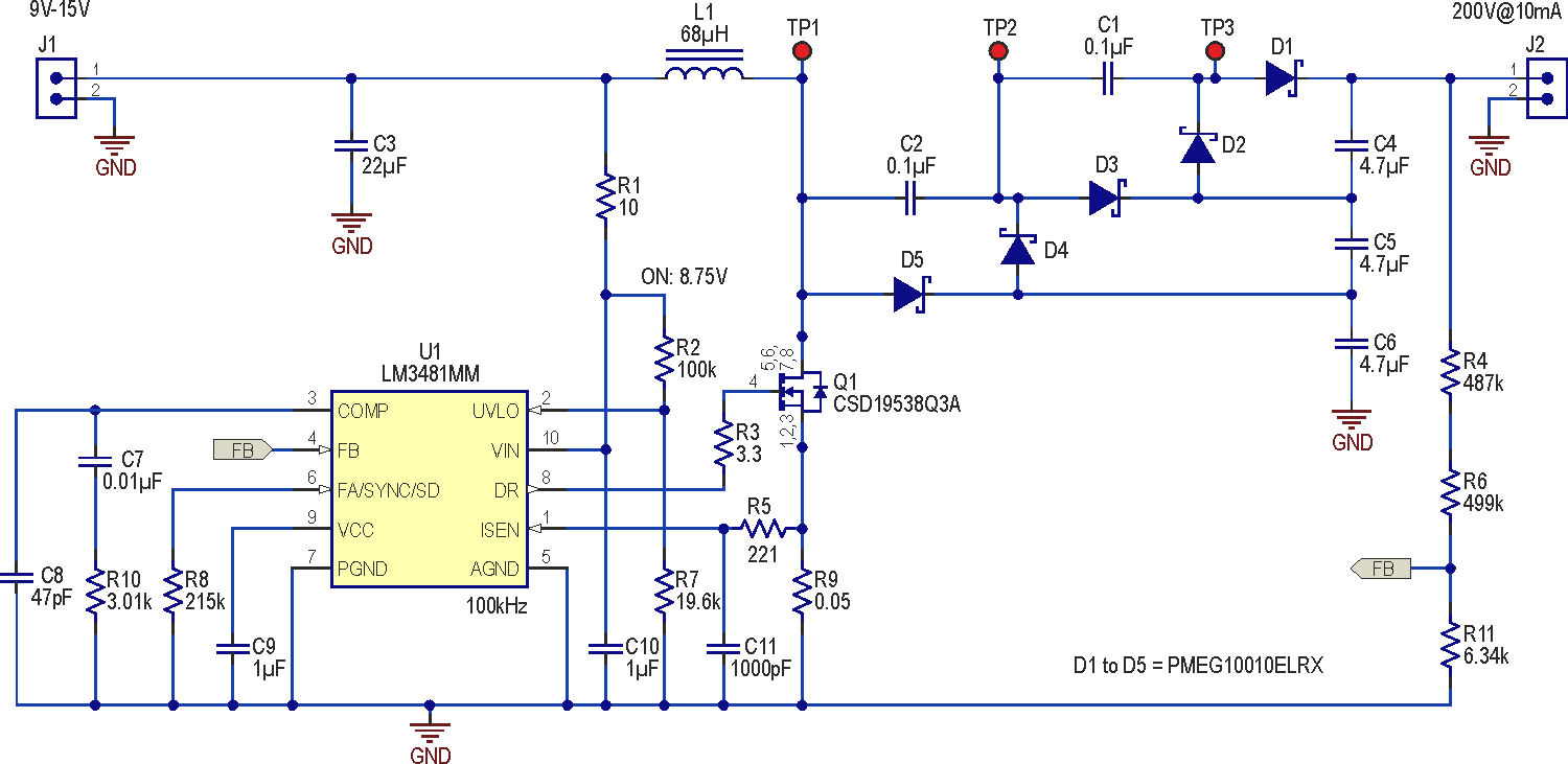

In Figure 2 is an example circuit that takes the doubler stage of Figure 1, and creates a tripler by adding one additional stage. As a multiplier by three times, each power stage component will operate at 33% of the output voltage, or 67 V max for a 200 V output. This allows the use of common 100 V components, providing an adequate 67% derating. The multiplier stages in this circuit can be scaled up as needed to decrease voltage stress further for the same output voltage, or to simply increase the output voltage.
Increase Output Voltage With A Voltage Multiplier
Figure 2. Boost converter with a voltage tripler reduces component voltage stress.
In Figure 3 are the switching waveforms present at TP1, TP2, and TP3 in the example circuit at full load and at 15 V input. As expected, the lower waveform is that of a typical DCM boost converter set to 67 V. The upper two waveforms are identical in shape to the first, but level-shifted by 67 V and 134 V by the multiplier stages. The top waveform (TP3) is then peak-detected by D1 to charge the output capacitors to the 200 V output voltage.

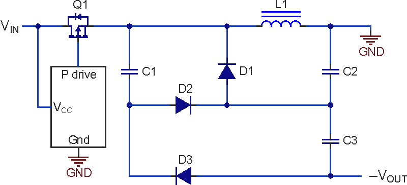

The Figure 4 shows an inverting buck-boost converter with an alternate arrangement of the multiplier components to generate a negative output voltage. Operation is similar to that of Figure 1.
Figure 4. An inverting buck-boost converter with an alternate
arrangement of the multiplier.
When FET Q1 is on, the input voltage is imposed across L1, storing energy, while C1 charges to |VIN+VOUT/2| through D2. The energy transfer capacitor voltage on C1 is higher than that seen on the boost converter. After Q1 turns off, the current in L1 forces D1 to conduct, as in a standard inverting buck-boost, pulling D1’s cathode voltage to –VOUT/2. On that transition, D3 conducts, transferring charge stored in C1 into C3. While the voltages on C2 and C3 are not equal, they are different by the magnitude of the input voltage. So for low-input to high-output voltage ratios, this difference is usually insignificant.
In this application, a P-channel FET is a good choice because the controller used only needs to be rated for the maximum input voltage, since it is ground referenced. A connection to the switching node is not needed when using a P-channel FET. This would be required for an N-channel FET, and since most buck controllers are limited to less than 100 V, this severally limits the negative output voltage. Regardless of the controller used, the sensed negative output voltage must be inverted with an operational amplifier (op amp) to provide a positive feedback voltage for regulation.
