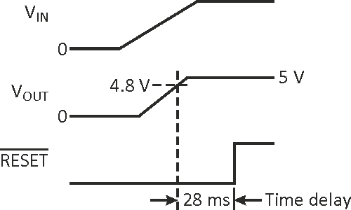

The first time I was burned by a 555 was back in the 1980s, when I tried to use one as a reset generator in a military communication system (Fig. 1). When I applied power, there was nothing consistent about the one-shot pulse out of the 555. Fortunately, Electromagnetic Systems Laboratories (now TRW) had some “greybeard” analog guys that could school me. They explained no IC with latches and such could be trusted to behave consistently on power-up. It’s a digital chip at heart. Things would go wrong depending on how fast or slow the power rail came up. There was always the fun of power spikes caused by relays or switches that apply the power. There was also the condition of rapid power cycling that would make the performance of the IC unpredictable.
What's All This 555 Timer Stuff, Anyway?
Figure 1. This Texas Instruments timing chart shows the requirement for a 28-ms
delay on releasing a microcontroller RESET pin after the power-supply
voltage reaches 4.8 V.
When I asked them what was I to do, they all replied, “You have to make a reset circuit out of a few discrete transistors and capacitors and resistors, and you have to intimately understand how it works under all those conditions.” Thankfully, since those early days, companies like Maxim have developed entire portfolios of reset ICs that do behave very predictably and can save space and cost over a discrete circuit (Fig. 2). Please pay Maxim whatever they ask rather than think you can cheap-out with a 555 timer.

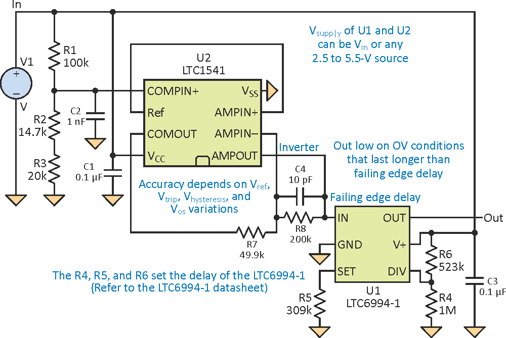

Thankfully, just like Maxim solved your power-on reset problems, Linear Technology has solved your 555 timing problems with its line of TimerBlox chips. Indeed, LTC says you can use TimerBlox for doing power-on reset as well (Fig. 3). Leave it to analog companies to understand the transistor-level operation of their parts, as opposed to some IBIS approximation of digital behavior.
Figure 3. Linear Technology developed this power-on-reset using one of its TimerBlox parts.
And blissfully, the TimerBlox circuits don’t require any capacitors, so all of the headaches with leakage or stray capacitance or microphonics or reliability go away. My pal Tim Regan (Fig. 4) was application manager at Linear Tech when the TimerBlox came out. Tim developed an Excel spreadsheet to help you use TimerBlox chips. Tim is retired now, but when I asked about TimerBlox, he noted:
