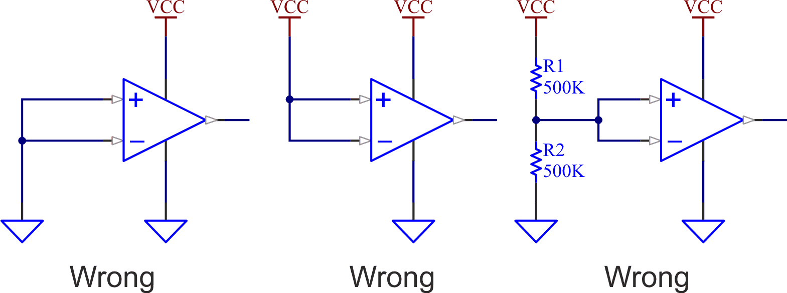

The tendency to connect inputs to power or ground made some engineers feel that was the way to deal with unused op-amp inputs (Fig. 1). This is a serious mistake. Connecting both inputs of an operational amplifier together just means that the offset voltage will determine if the output is hard-driven to the positive or negative rail. The offset voltage of a particular part will determine which rail the output goes to, independent of where you tied the inputs.
Wrong, wrong, and wrong. You should never tie the unused...
Figure 1. Wrong, wrong, and wrong. You should never tie the unused "+" and "–" pins of an
amplifier together. It’s guaranteed to drive the output to one power rail or the other,
and with a large expenditure of chip power-supply current.
When an output is hard-driven, there’s no feedback that “closes the loop” and stops supplying drive current to the output transistors. Most bipolar op amps have base-current clamping circuits that will limit this current so it doesn’t burn up the chip. CMOS amplifiers will also draw more current when the output is hard-driven, and it’s never good to put any transistor inside an integrated circuit into saturation.

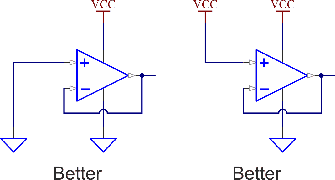

A better, but not guaranteed, way to deal with unused inputs. You should tie to the rail that's in the input common-mode range. For rail-to-rail parts, you should measure power consumption when tied to each rail. With a part that has high offset voltage, it still might cause output saturation.
Figure 2. A better, but not guaranteed, way to deal with unused inputs. You should tie to the rail
that’s in the input common-mode range. For rail-to-rail parts, you should measure power
The right thing to do is connect the amplifier as a voltage follower, with the "–" pin connected to the output pin (Fig. 2). But you can’t always just take the "+" input to a power rail – it might cause the same problem. You have to ensure the positive input is connected to a voltage inside the input common-mode range. Even that might not be enough if you don’t understand the input section of the amplifier.

Even rail-to-rail input amplifiers may draw excess current when you connect the "+" input to one of the power rails. So, as Pease noted, even when you connect as a voltage follower, you’re best off with putting two resistors as a ladder and connect the "+" pin to the midpoint, to ensure the common-mode input range is at its middle and the op amp can close the loop for the voltage follower (Fig. 3).
The best way to deal with unused amplifiers is to bias the voltage follower at the midpoint of the common-mode input range. Another way is to just connect the voltage-follower input to another signal.
