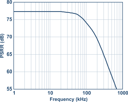

Fixed frequency or pulse-width modulated (PWM) switching regulators provide a very efficient (often >90%) means of generating voltage rails in a measurement system at medium to high load currents (hundreds of mA to multiple A). However, this efficiency comes at the cost of switching ripple that is usually at a fixed frequency of hundreds of kHz to a couple of MHz. As seen in Figure 1, the power supply rejection ratio (PSRR) of a typical precision SAR ADC is very good at low frequencies up to ~100 kHz – beyond this the PSRR drops off rapidly.

Figure 1. SAR ADC analog power supply rejection vs. frequency.

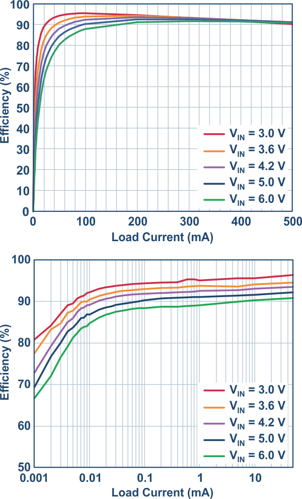

In hysteresis mode, the regulator charges the output voltage slightly higher than its nominal output voltage with PWM pulses by regulating the constant peak inductor current. When the output voltage increases until the output sense signal exceeds the hysteresis upper threshold, the regulator enters standby mode. In standby mode, the high-side and low-side MOSFETs and a majority of the circuitry are disabled to allow a low quiescent current as well as high efficiency performance, as seen in Figure 2. During standby mode, the output capacitor supplies energy into the load, and the output voltage decreases until it falls below the hysteresis comparator lower threshold. The regulator wakes up and generates the PWM pulses to charge the output again.

Figure 2. PWM (top) and hysteretic mode (bottom) –
efficiency vs. load current.
In the hysteretic case, the switching ripple frequency is a function of the load current and LC network and for loads of a couple mAs is in the kHz range. At a few kHz, the PSRR of the precision ADC is very good and will do a good job of rejecting/attenuating the switching ripple at the ADC digital output.

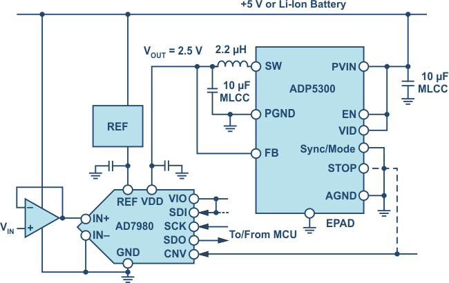

Take for example the circuit shown in Figure 3 with the AD7980 ADC; its VDD current consumption is typically 1.5 mA at full throughput (1 MSPS) and scales linearly as you decrease the throughput. As can be seen in Figure 4, the switching frequency ripple is 4.5 kHz and 50 mV peak-to-peak on a 2.5 V regulated output from a 5 V rail. This ripple is attenuated at the ADC digital output by the PSRR rating of the ADC. In the ADC FFT output it shows up as a spur of magnitude –120 dBFS at 4.5 kHz. For a 5 V input range on the ADC, this equates to

This measurement is similar to what is shown in Figure 1 for the AD7980 PSRR of ~77 dB at 4.5 kHz.
