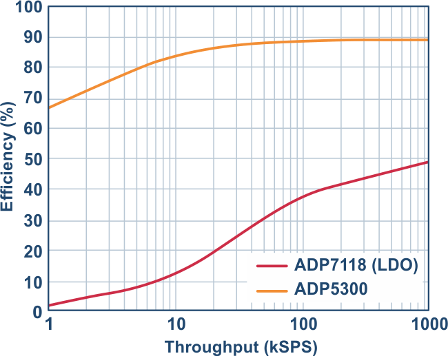

Figure 6 shows how the efficiency of the ADP5300 stacks up vs. that of an LDO across ADC throughput rate when regulating a 2.5 V output from a 5 V rail. As you would expect, the switcher is far more efficient at delivering power than the LDO, 90% vs. 50% (for a 5 V input) at 1 MSPS and holds up much better at lower ADC throughputs/lower current consumption, staying above 80% until 5 kSPS.
Powering a precision SAR ADC using a high efficiency, ultralow power switcher in power sensitive applications
Figure 6. Efficiency vs. ADC throughput for ADP5300 and LDO.
At an ADC throughput of 1 MSPS using an LDO, the current consumed from a 5 V rail is 1.5 mA or 7.5 mW. Using the ADP5300, the current consumed from a 5 V rail is 828 μA or 4.1 mW. This is a 3.4 mW or 45% reduction in the power drawn by the ADC power supply.

The cost and PCB area of a switcher solution like the ADP5300 is comparable to that of an LDO. The main addition to the BOM is a chip inductor, a 2.2 μH inductor can be as small as 0603 size, with the input and output caps already being required for an LDO solution. This makes it an attractive alternative to using an LDO in power sensitive applications without significantly impacting precision performance.
High efficiency, ultralow power switching regulators like the ADP5300 result in 45% power savings over LDOs when powering precision ADCs like the AD7980 from a 5 V rail. This has many benefits in IoT applications, extending battery life in wireless sensor nodes or wearable fitness devices, power sensitive isolated industrial systems, and 4 mA to 20 mA loop-powered systems.
