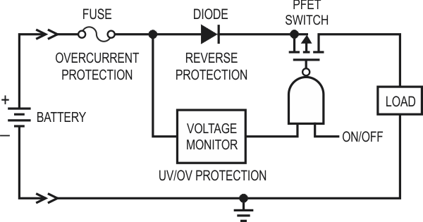

Even simple battery related problems, not just fires and explosions, can tarnish a product’s reputation. Therefore, attention needs to be paid to the design of battery related safety features. Batteries come with their charge and discharge current ratings; exceeding these ratings heats up the battery, which not only reduces the life of the battery but explodes it in the worst case. Overcurrent protection may be implemented with fuses, but fuses are bulky, slow to react and have wide tolerances in their trip threshold (Figure 1). To prevent irreparable damage, rechargeable batteries need to be disconnected before going into deep discharge. For a 3.7 V Li-Ion cell, this level is around 2.5 V. An undervoltage lockout (UVLO) circuit is needed to disconnect the battery from the load. This may be implemented with a comparator, reference voltage, and a solid-state switch. A P-channel MOSFET high-side switch doesn’t need a charge pump to turn it on, lowering battery current drain, but P-channel MOSFETs have limited selection and cost more than N-channel MOSFETs for the same on-resistance. Conversely, a more efficient N-channel MOSFET low-side switch may be used if the ground line can be floated. The undervoltage threshold needs to have sufficient hysteresis; otherwise, the UVLO circuit will oscillate off-on-off since battery voltage recovers after load turn-off.
Switching & Protecting Electronics in Battery-Powered Systems
Figure 1. A Possible Battery & Load Protection Discrete Circuit
After battery protection, we need to consider load protection. Transient voltage suppressors implement overvoltage protection during brief conditions such as ringing, spikes and surges, but burn up during sustained or DC overvoltages (OV). Therefore, another comparator is needed to protect the load from an input overvoltage. If a battery is misinserted with reversed polarity, the load may be damaged if it cannot tolerate negative voltages. A series diode is used to block the negative voltage. But, this diode dissipates power and drops significant voltage during forward operation.
As seen, a bunch of discrete components and circuits are needed to implement comprehensive protection for battery-powered systems. At the same time, the quiescent current consumption of these circuits needs to be kept low so that battery run- and standby-time is not shortened. For example, automotive electronic modules have a standby current budget of less than 100 μA to prevent battery discharge while a car is parked for a few weeks. For high current dissipating circuits, a relay may be used to disconnect them from the battery. Relays are also used to turn the load on and off but relays are bulky, preventing form-factor reduction. A more efficient and simpler protection method is needed.

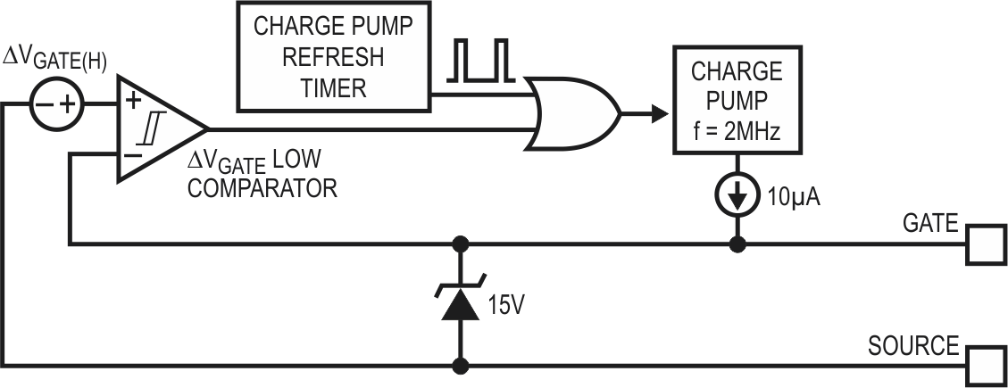

To lower quiescent current, LTC4231 activates the charge pump periodically to refresh the MOSFET gate voltage as needed.
Figure 4. To lower quiescent current, LTC4231 activates the charge pump periodically

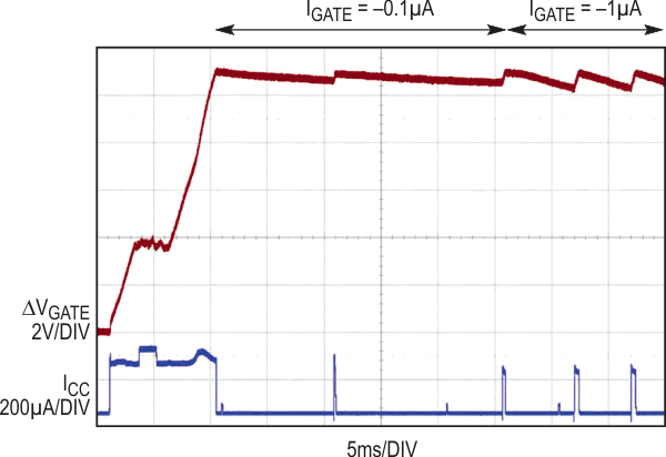

The LTC4231 employs two innovative techniques to lower its current consumption during normal operation while providing protection that is indistinguishable from other current-hungry controllers. To turn on the external N-channel MOSFETs and lower their on-resistance, the LTC4231 uses an internal charge pump to generate a gate voltage at least 10 V above the input voltage. In other controllers, the charge pump works continuously even after the gate is driven on, essentially idling but contributing significantly to quiescent current consumption. In contrast, the LTC4231 turns off the charge pump after the MOSFET gate reaches its peak voltage. If the gate voltage sags due to leakage, the charge pump turns on to deliver a pulse of charge, refreshing the gate voltage. This is shown in Figures 4 and 5 for example gate leakages of 0.1 μA and 1 μA. This technique reduces charge pump current consumption by a factor of 50x to 100x as the charge pump on current is 200 μA but drops to 2 μA in sleep mode.
The MOSFET gate voltage refresh rate is shown for two different gate leakage examples (ΔVGATE is GATE-to-SOURCE voltage, ICC is LTC4231's current consumption).
Figure 5. The MOSFET gate voltage refresh rate is shown for two different
ICC is LTC4231’s current consumption).

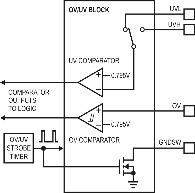

The second technique to lower LTC4231’s quiescent current is to sample the input voltage every 10 ms to determine if it has gone below the undervoltage threshold or above the overvoltage threshold. A strobed ground connection (GNDSW) is provided for the external input voltage resistive divider (Figure 6). The occasional sampling lowers the resistive divider’s current consumption by 50x, which is the sampling period (10 ms) divided by the sampling window (200 μs). The comparators monitoring the UVL, UVH, and OV pins are turned on during the sampling window, lowering their average current consumption also by 50x. The 10 ms sampling period works well for batteries since their voltage changes slowly over time. However, if the undervoltage or overvoltage condition occurs at start-up, the LTC4231 holds the MOSFETs off to block the out-of-range voltage from propagating to the load.
The input voltage is monitored in a 200 μs window every 10 ms (2% duty cycle) to lower UV/OV monitoring current consumption by 50x
Figure 6. The input voltage is monitored in a 200 μs window every 10 ms (2% duty cycle)
to lower UV/OV monitoring current consumption by 50x. During the sampling
window, GNDSW is connected to GND by an internal 80 Ω switch.
