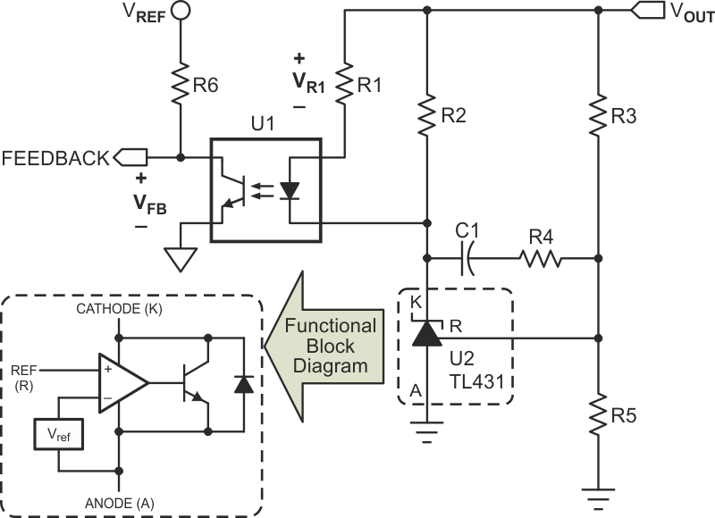

In isolated power supplies, optocouplers pass the feedback signal across the isolation boundary. Optocouplers contain both a light-emitting diode (LED) and a photo detector. Current flowing through the LED results in a proportional current flowing in the photo detector. The current transfer ratio (CTR) is the current gain from the LED to the photo detector, and typically has a very wide tolerance. When you are designing an isolated feedback network, you must consider the tolerance of the optocoupler and all other components that determine the large signal gain. Neglecting this task could easily result in returns after your product goes to production.
The schematic for an isolated feedback network, shown in Figure 1, is the most common implementation. TI’s TL431 contains both an error amplifier and reference. The resistor divider of R3 and R5 and the internal reference of the TL431 set the output voltage. The feedback network controls the power delivered to the power-supply output by varying the voltage on the feedback pin of the pulse-width modulation (PWM) controller. When VOUT drifts higher, the TL431 cathode pulls more current through the optocoupler, which pulls the feedback pin lower. When VOUT drifts lower, the TL431 cathode commands less current from the optocoupler, allowing the feedback pin to float higher.
Make sure your optocoupler is properly biased
Figure 1. This circuit commonly generates the feedback signal
in isolated power supplies.
A proper design must ensure that this circuit is capable of driving the feedback pin of the controller over its entire dynamic operating range while considering worst-case tolerances of all major variables.

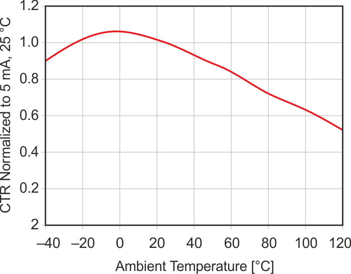

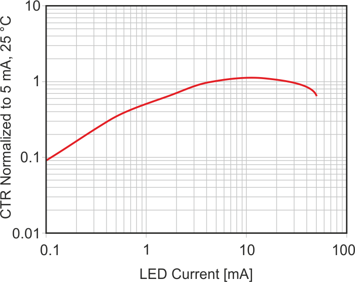

The second step is to calculate the worst-case CTR of the optocoupler. Optocouplers with “817” in the part number are offered from numerous manufacturers which are pin-for-pin compatible with each other; each uses a different prefix in the part number. Table 1 shows examples of 817 devices with different CTR ranges, denoted by a single-letter suffix in the part number. This CTR range does not include the effects of temperature and bias current. Charts from the optocoupler datasheet, recreated in Figures 2 and 3, summarize the effects of temperature and bias current.
Figure 3. Optocoupler CTR varies with bias current.
Assume that you expect your supply to operate in a –40 °C to 85 °C environment. From Figure 2, you know that you need to multiply the minimum CTR by a factor of about 0.7 at 85 °C. If you select the “A” version of the 817, your minimum CRT can now be as low as 56%. Dividing the result of Equation 1 by 0.56 tells you that you may require at least 4.96 mA of LED current, not including the effects of bias current. From Figure 3, you can see that the bias-current effects at 4.96 mA are negligible.
