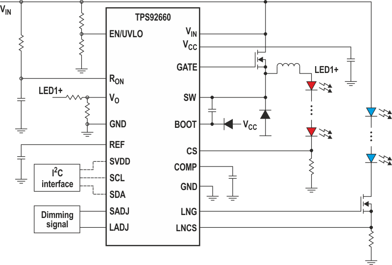

A two-string dimmable LED driver uses a buck converter for one string and a linear regulator for the second string.
Figure 1. A two-string dimmable LED driver uses a buck converter for one string and
Basically, there are two ways to achieve LED dimming: analog or linear current control and pulse-width modulation (PWM). Both dimming methods change the LEDs’ brightness by controlling the average current through the LED string. Both can be implemented in either a switch-mode or linear LED driver. Fig. 1 shows a two-string LED driver containing one buck switcher and one linear regulator, based on the TPS92660. Both LED strings can be dimmed with either analog or PWM techniques. There are advantages and disadvantages to each. In most applications, the dimming method is chosen based on the color mixing performance requirement.

The LED current can be adjusted by changing VREF in some cases. Note that not all LED driver ICs allow users to change the LED current reference voltages. For those ICs that allow the change of the LED current reference, there are generally two ways to do so. The first is to apply an analog voltage on the reference voltage adjust pin provided by the IC. One example is Texas Instruments’ LM3409. The user can adjust the LED current by adjusting the voltage on the IADJ pin. The second way is to adjust the reference voltage through a digital communication interface like I2C. One example is Texas Instruments’ TPS92660, which has an I2C interface that allows users to adjust LED current reference voltages through I2C commands.

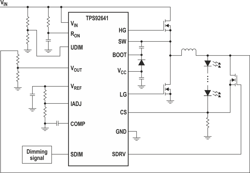

Shunt FET PWM dimming
Shunt FET (field effect transistor) PWM dimming often is used for very high-frequency LED PWM dimming. Fig. 4 shows a buck regulator- based shunt FET PWM dimming circuit. An external shunt FET is placed in parallel with the LED string to quickly bypass (short) the converter’s output current. The LED string is shut off when the shunt FET is on and is turned on when the shunt FET is off. So the LED string is effectively PWM dimmed by this shunt FET. Some LED driver ICs integrate a MOSFET driver for shunt FET PWM dimming and eliminate the need for an external MOSFET driver.
Figure 4. Shunt FET PWM dimming is implemented with a FET in parallel with the LED string.
The switching regulator’s inductor current stays continuous during shunt FET PWM dimming. There is no delay caused by inductor current ramping up or down. With a strong MOSFET driver, the shunt FET can be turned on and off at very high speeds. Consequently, the PWM-dimmed LED current has very sharp rising and falling edges. The shunt FET PWM dimming is ideal for high-frequency PWM dimming applications.
