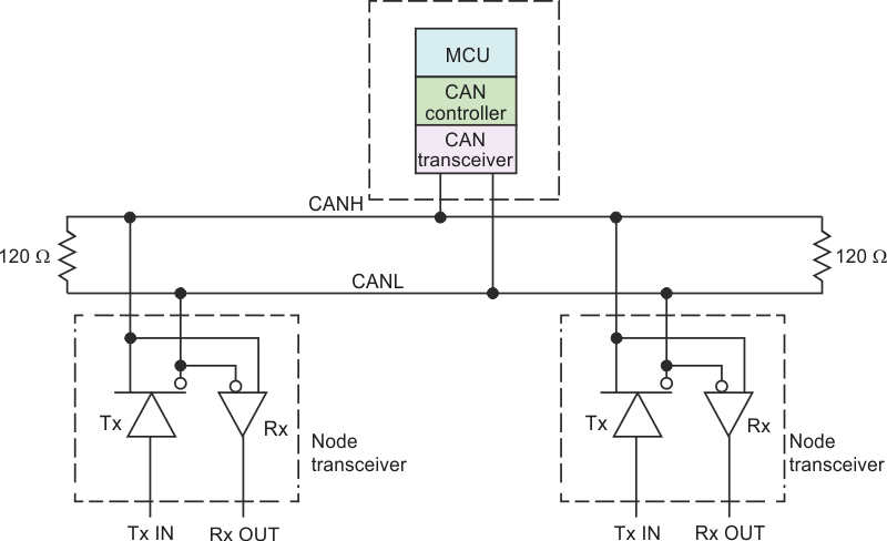

CAN is a serial interface standard developed by Robert Bosch and blessed by the Society of Automotive Engineers (SAE) back in the 1980s. Since then, because of its flexibility and ruggedness, it’s been widely adopted in vehicles and many industrial applications. The topology is a differential bus using shielded or unshielded twisted pair that can accommodate up to 127 nodes. All of the nodes are transceivers that can send and receive. Standard transceiver ICs are available, but many microcontrollers have an integrated CAN interface (Fig. 1).
This CAN bus topology shows an MCU with a CAN interface and other transceiver nodes.
Figure 1. This CAN bus topology shows an MCU with a CAN interface and other transceiver nodes.
