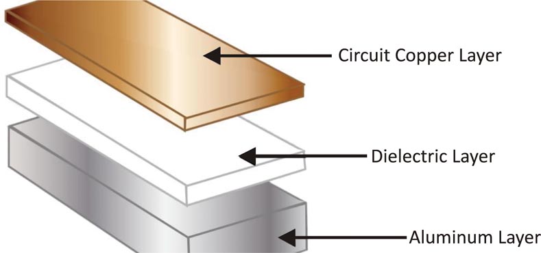

Compared with the common FR-4 rigid-flex substrates, the aluminum rigid-flex substrates have better heat dissipation performance and higher service life. The binding force of the PCB has a crucial impact on the reliability of the product, so it is necessary to study the surface treatment method of aluminum substrate, and then selecting a better binding force treatment method for production, which can improve the reliability of PCB, in order to meet the requirements of high reliability of electronic products.

Some Common Surface Treatment Methods of Aluminum Substrates
The surface treatment methods of aluminum substrates can be divided into physical grinding & brushing methods and chemical etching methods. The purpose of both methods is to form a certain roughness on the surface of aluminum substrate so as to increase the adhesion between the surface of aluminum substrate and the medium.

Chemical etching is through the reaction of solution and aluminum, which means that etching surface of aluminum substrate, so that the surface of aluminum substrate has a certain degree of roughness of the surface. Generally use alkaline solution, but because the aluminum itself is not resistant to strong alkali, so the need for operators in the actual operation of the process of strict control of the concentration of solution and reaction time.

The roughness of aluminum plate surface treatment is not the larger the better, but also need to consider the surface treatment morphology and uniformity. The alkali etching surface treatment is the best, which can provide a uniform micro rough surface.
Based on the above tests, the plate with alkali etching surface treatment technology before compression has high anti-aging performance and can provide the best adhesion force to ensure the high reliability of the end product.
