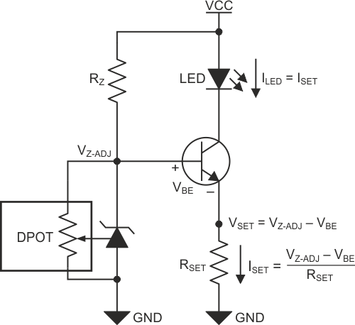

LEDs are usually biased with current; Figure 1 illustrates the most basic implementation of a programmable current source using a typical DPOT with an adjustable shunt reference. Varying the voltage across the Zener changes this circuit’s current. While the Zener approach is effective, a major drawback is that it requires additional components that leads to an increased bill of materials (BOM), footprint and ultimately cost – which is especially pronounced when biasing an array of LEDs. Further, the base-to-emitter voltage (VBE) of the transistor can also vary with temperature and collector current, which can be further undesirable to the design.
DPOT-based biasing.
Figure 1. DPOT-based biasing.

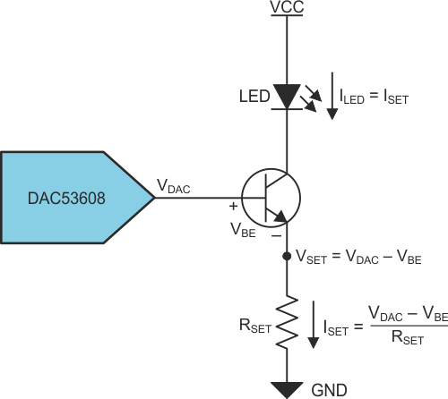

Another way to solve the biasing point programmability is to use a simple precision DAC to provide the biasing circuit. Figure 2 depicts this configuration, including the use of the 10-bit, 8-channel, buffered-voltage-output DAC53608. This approach provides a circuit with the smallest size and lowest BOM cost.
Programmable LED biasing circuit.
Figure 2. Programmable LED biasing circuit.
Keep in mind, however, that like the previous circuit, drift can exist within the VBE of the transistor, and the output may also require some headroom near the ground rail due to the expected VBE drop.
While the VBE can vary with temperature and collector current, you can ignore such variations in applications that place the circuit inside a larger feedback loop with gain. With that said, there may be concern for applications that are open loop and that do not employ temperature calibration. The drift in VBE due to temperature and collector current can lead to gain error and full-scale error at the system level.

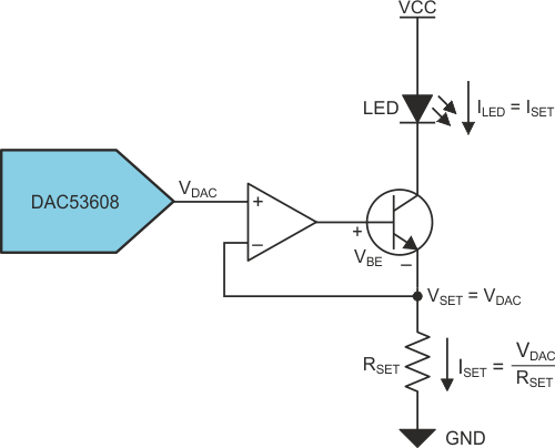

A robust way of compensating for such VBE variation is to place the circuit inside the feedback loop of an amplifier, as shown in Figure 3. This circuit is very suitable for applications that require high accuracy; the only drawback is the additional amplifier.
VBE compensation using buffer.
Figure 3. VBE compensation using buffer.

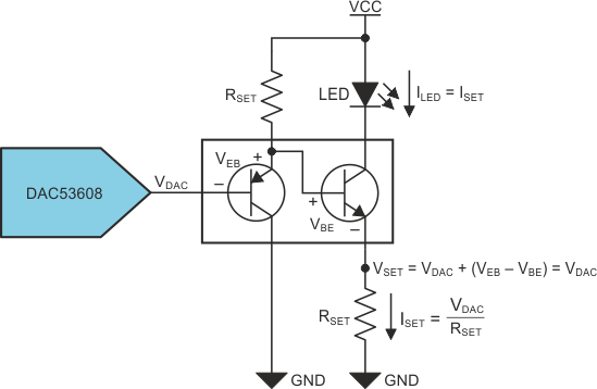

Figure 4 shows yet another approach for compensating VBE: using a matched pair of PNP and NPN transistors to cancel out the voltage variations and any headroom. As you can see, this circuit helps balance the benefits of accuracy, solution size and cost.
VBE compensation without buffer.
Figure 4. VBE compensation without buffer.
