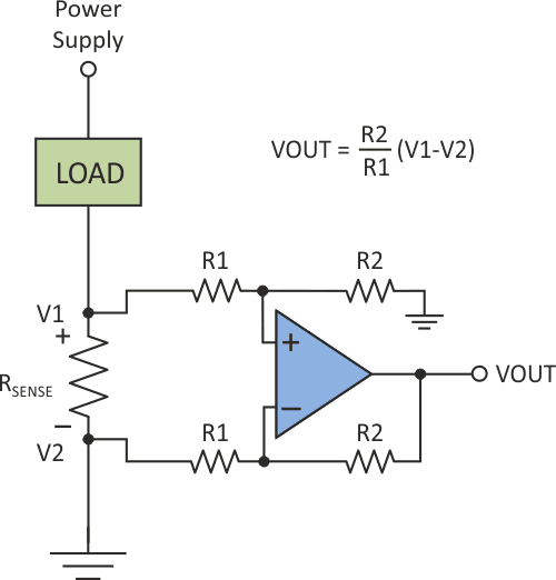

Low-side current sensing is the easiest method to use when designing circuits or choosing devices to do current measurements. Due to the low common mode voltage at the inputs, a difference amplifier typology can be used. Figure 2 shows the classical difference amplifier typology using an operational amplifier (op-amp).
When using an op-amp for current sense measurements, there are several performance requirements that need to be met to ensure correct operation. First, the operation amplifier needs to support common-mode input voltages to ground when operated from a signal supply. Since the difference amplifier typically gains the differential input signal, the swing to rail specification of the op-amp is important in order to ensure the signal is correctly passed to the output. For these reasons, rail-to-rail input and output operation amplifiers are generally preferred for current sense measurements. Since operational amplifiers are not specified in the difference amplifier configuration, it is difficult to tell what the performance can be in the real application. Parameters such as slew rate, bandwidth, input current, common mode rejection, and drift are all degraded when resistors around the op-amp are added to create the current sense circuit. The parametric degradation depends on the closed loop gain of the amplifier and values of the gain setting resistors. Figure 2 shows the matching and tolerance of R1 and R2. They need to be considered when implementing a discrete solution since variations in these components directly affect the circuit gain error.
Operational Amplifier Configuration for Low-Side Sensing.
Figure 2. Operational Amplifier Configuration for Low-Side Sensing.
Another factor to consider when implementing a discrete current sense amplifier is the PCB layout. R1 and R2 need placed as closely as possible to the operational amplifier and current sense resistor. By placing these components close the op-amp the likelihood of noise pickup on the operational amplifier positive input is reduced. Since many current sense amplifiers are used with DC/DC convertors, the placement of the entire current sense circuit needs to be carefully considered to avoid radiated noise by the DC/DC power supplies. Figure 2 shows how to calculate the difference amplifier gain. However, any increase or decrease in the gain affects the solution stability and bandwidth. The stability of the op-amp requires special consideration in applications where a capacitive load is present to avoid oscillations or excessive output ringing.
