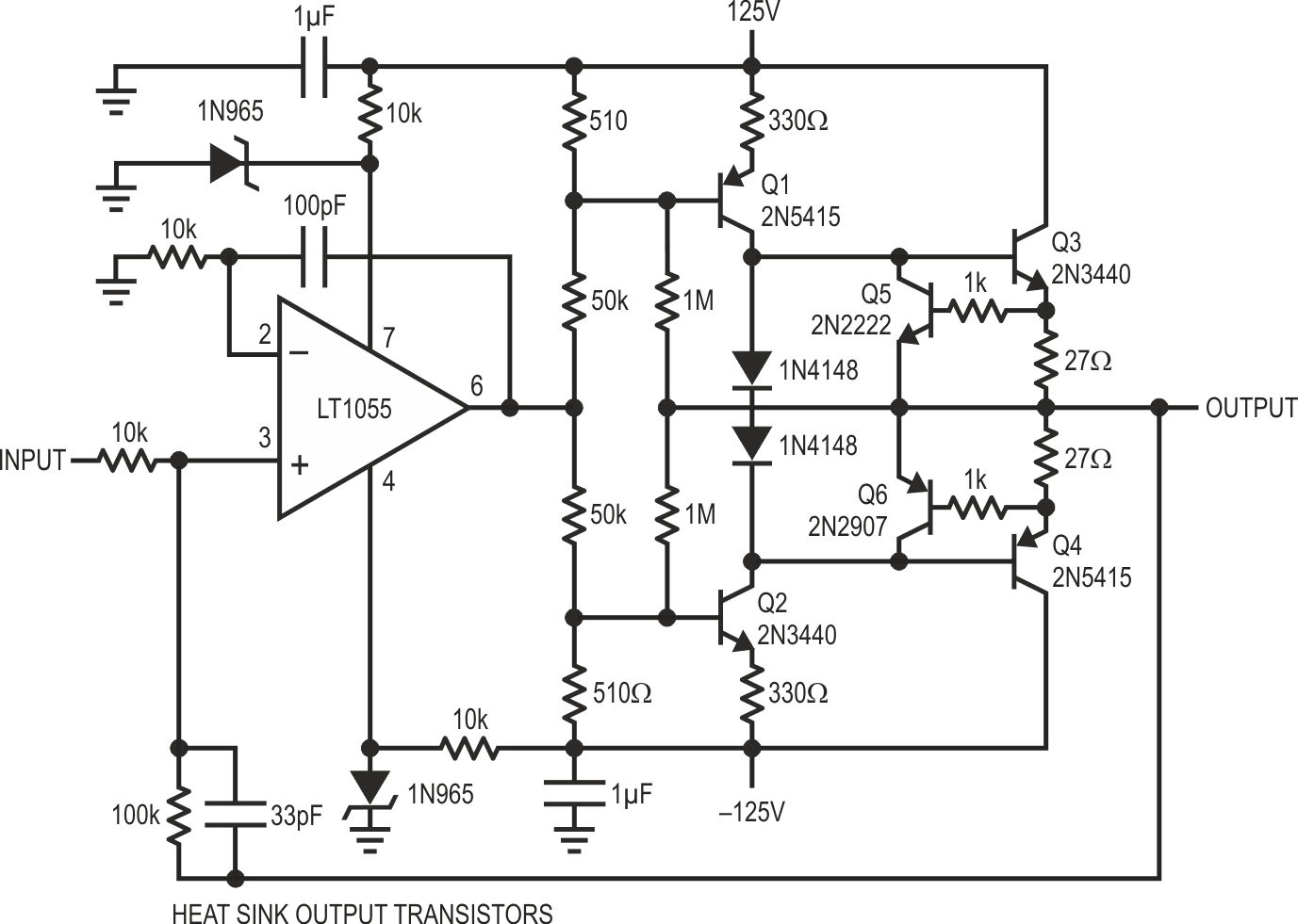

It wasn’t very long ago that adapting an op amp to deliver voltages at about 50 V or higher was a challenge. It was usually accomplished by starting with a standard op amp in the 15-to-24-V range, then boosting its output with discrete transistors. This could look simple in principle with complementary PNP and NPN devices (Figure 1). However, achieving symmetrical performance was difficult and the better circuit required more passive components (Figure 2).
An improved voltage-boosting circuit requires significantly more components to ensure symmetrical and linear performance across the output's swing range.
Figure 2. An improved voltage-boosting circuit requires significantly more components to ensure symmetrical and linear
performance across the output’s swing range.
Fully characterizing the performance across all load and other conditions was time consuming and needed analysis based on the unavoidable tolerances of these added components. There were also pre-packaged hybrid devices that were effective for the higher voltages; these used an op amp packaged with the requisite associated components all in a small package, which looked electrically like an op amp, but with higher-voltage capability, and overload and thermal protection as well.

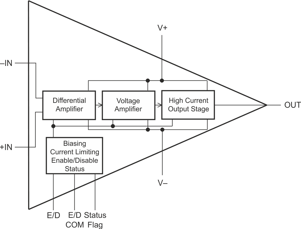

Fortunately, in the last few years, IC vendors have worked to overcome the process limitations that restricted analog components to those lower voltages. For example, the Texas Instruments OPA462 high-voltage (180 V), high-current (30 mA typical, 45 mA maximum) op amp operates from a ±6 V (12 V) to ±90 V (180 V) bipolar supply and has a 6.5 MHz gain-bandwidth product and slew rate of 32 V/μs (Figure 3). The package’s diminutive size is quite impressive, with a body size of about 5×4 mm (plus external leads).
The Texas Instruments OPA462 op amp can provide ±90 V outputs while delivering to 30 mA typical.
Figure 3. The Texas Instruments OPA462 op amp can provide ±90 V outputs while delivering to 30 mA typical.

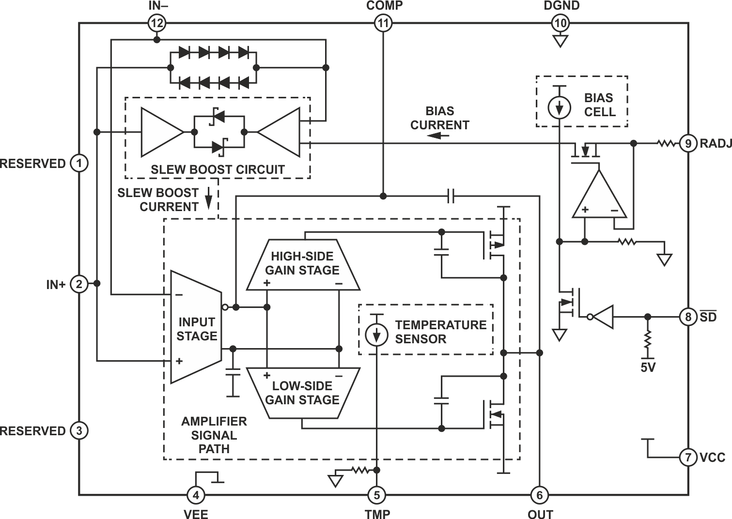

TI is not the only recent entry into the area of these higher-voltage op amps. Analog Devices has the ADHV4702-1, a 24 V-to-220 V precision op amp that can use symmetrical or non-symmetrical supplies (Figure 4). This op amp has a typical slew rate of up to 74 V/μs and 10-MHz small signal bandwidth. The 12-lead device measures just 7×7 mm and is compliant with the spacing called out by IEC 61010-1, ”Safety requirements for electrical equipment for measurement, control, and laboratory use – Part 1: General requirements” (references 2 and 3).
The ADHV4702-1 from Analog Devices is a 220-V device that can use symmetrical or asymmetrical bipolar supplies.
Figure 4. The ADHV4702-1 from Analog Devices is a 220-V device that can use symmetrical or asymmetrical bipolar supplies.
