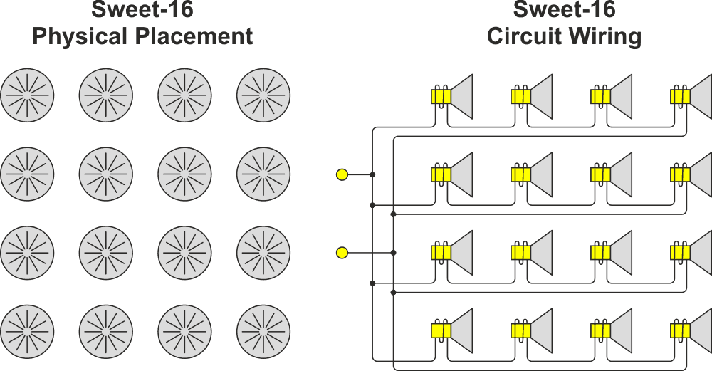

Some suggested wiring diagrams were provided, but one possibility was overlooked (Figure 1).
The 16 speakers could be interconnected so that their composite impedance at the two terminals would be the same as the impedances of the individual speakers themselves.
Figure 1. The 16 speakers could be interconnected so that their composite impedance at the two terminals would
The 16 speakers arranged four-by-four could be interconnected so that their composite impedance at the two terminals would be the same as the impedances of the individual speakers themselves. For example, if each of the speakers presented 8 Ω of voice coil impedance, the composite of 16 speakers would present that same 8 Ω.

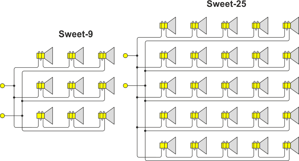

The wiring diagram is shown in Figure 2.
One could make a three-by-three or five-by-five array and achieve much the same results.
Figure 2. One could make a three-by-three or five-by-five array and achieve much the same results.
In each case, the composite impedance would be the same as each speaker voice coil’s individual impedance.
