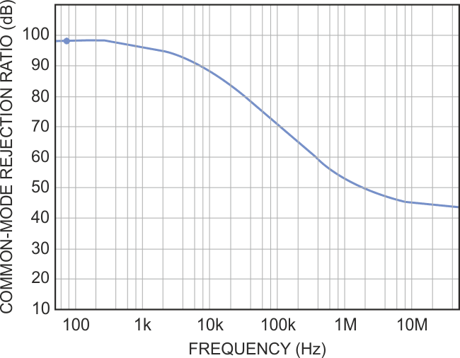

You can see that the output is the difference of the two inputs times a gain factor that you can set to any desired gain, including unity. Equation 2 holds true because the same chip integrates all the resistors; therefore, their values match tightly. The low-frequency common-mode rejection ratio is approximately 98 dB (Figure 2). Because of the tight matching, the circuit can achieve a temperature coefficient of 15 ppm/°C. Although the circuit has lower performance than precision instrumentation amplifiers, it is adequate for many low-cost applications.
A plot for common-mode rejection ratio versus frequency for the circuit in Figure 1 yields a figure of 98 dB.
Figure 2. A plot for common-mode rejection ratio versus frequency for the circuit
