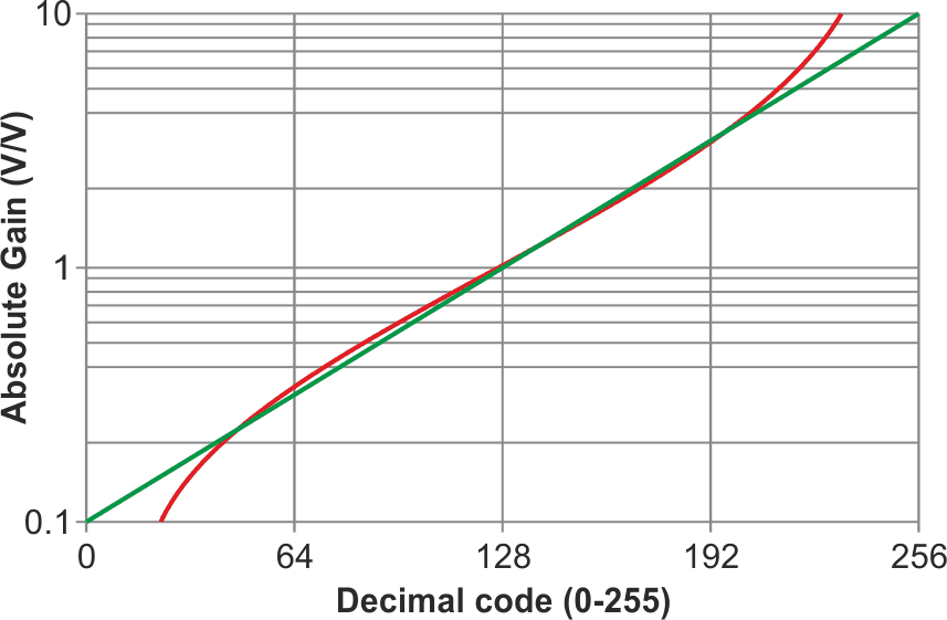

A common problem for digital potentiometers (DigiPots) is the effect of wiper resistance, which produces quite noticeable non-linearities of regulation at both ends of the resistance range. These effects also lead to an increased tempco in these areas, since the high wiper resistance temperature coefficient will dominate.
Figure 1 is reproduced from Figure 4-6 on the datasheet for the “Digital Potentiometer MCP41xxx/42xxx” (Microchip, DS11195C, page 15). The absolute gain response is quite typical, so it is repeated as a good illustration. The circuit uses the DigiPot as a gain control element, the green line is added to show the ideal gain control.
| Figure 1. | Gain versus decimal code for inverting and differential amplifier circuits (red line) reproduced from Digital Potentiometer MCP41xxx/42xxx and ideal gain control (green line). |
