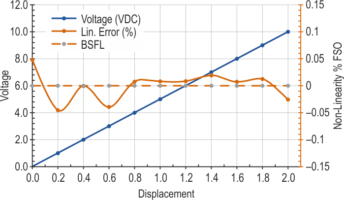

To illustrate the effects of linear­ity error, consider a sensor with a range of 0 to 2 inches, an output of 0 to 10 V dc, and its linearity error specified as ±0.25% of FSO. The sensor has a scale fac­tor of 5 Volts per inch and an FSO of 10 Vdc, so non-linearity could cause an error of ±25 mV in the output, which is equivalent to an error of ±0.005 inches. The user must then decide whether this level of error is tolerable.
Non-Linearity Plotted to Output.
Figure 1. Non-Linearity Plotted to Output.
This is illustrated by the graph in Figure 1, which shows both the sensor’s analog output in blue and its point-by-point error from the reference line in orange. Keep in mind that the units of the error are so much smaller than the unit of output that if shown along the blue line they would be indis­cernible in terms of resolution.
