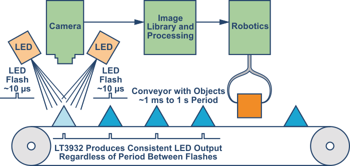

An example of machine vision on an industrial conveyor belt. Inspection systems move at many different speeds, yet the flash technology must be fast and crisp.
Figure 1 An example of machine vision on an industrial conveyor belt. Inspection systems move at many

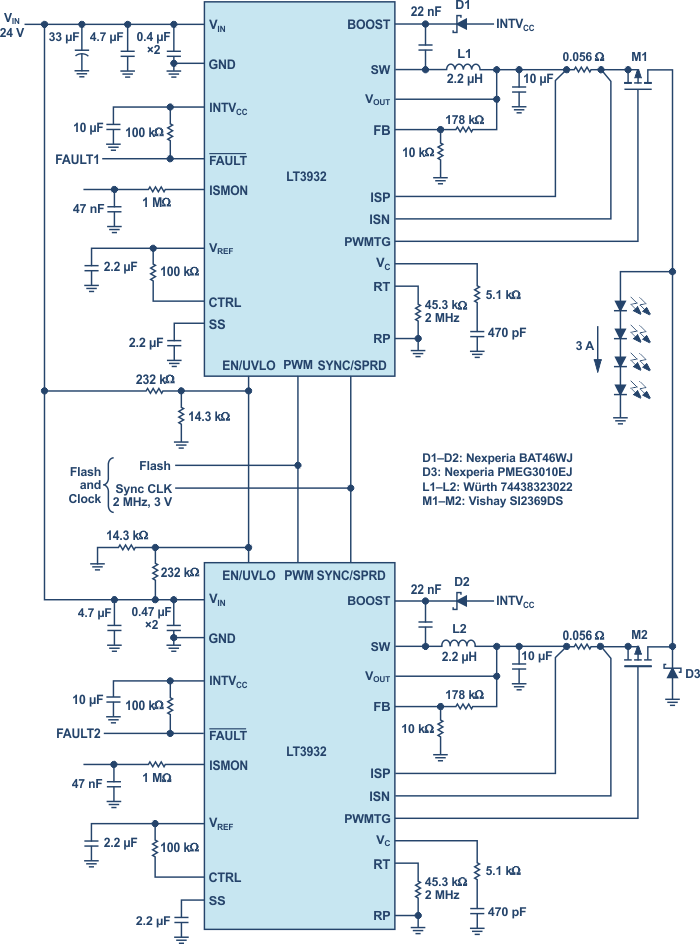

The proprietary flash technology of the LT3932 scales up when drivers are paralleled for increased LED flash current. The desired flash shape and integrity are maintained. Figure 2 shows how easy it is to parallel two drivers for a 3 A camera flash – designs up to 4 A are possible.
Parallel LT3932 1.5 A LED drivers yield 3 A machine vision LED pulses with long off-times relative to standard PWM dimming frequencies.
Figure 2 Parallel LT3932 1.5 A LED drivers yield 3 A machine vision LED pulses with long off-times

LED drivers act as current sources, regulating the current sent out through the light emitting diodes. Since current only flows in a single direction to the output, multiple LED drivers can be placed in parallel and their currents sum through the load. Current sources do not need to be protected against current running backward through one converter or having mismatched outputs. Voltage regulators, on the other hand, are not inherently good at current sharing. If they are all trying to regulate the output voltage to a single point, and there are slight differences in their feedback networks, a regulator may draw reverse current.
An LED driver maintains its output current, regardless of other drivers that may supply additional current summed at the output load. This makes paralleling LED drivers quite simple. For example, the LED flash system of two parallel LT3932 LED drivers shown in Figure 1 efficiently drives 4 LEDs at 3 A with short 10 µs pulses spread out by long periods of time – defined by the machine vision system. Each LT3932 converter sources half of the total string current during PWM on-time and turns off and saves its output state during PWM off-times. The off-time can be short or long, with no effect on the flash waveform repeatability.

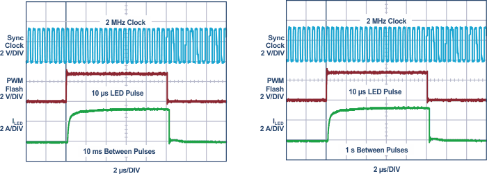

3 A camera flash waveform of Figure 1's parallel LED drivers looks the same regardless of the amount of PWM off-time. Waveforms show that a 10 µs pulse after (a) 10 ms and after (b) one second are the same. The LT3932 LED flash also looks the same after a day or longer of PWM off-time.
Figure 3 3 A camera flash waveform of Figure 1’s parallel LED drivers looks the same regardless of the amount of PWM off-time.
Parallel camera flash applications share nearly the same simplicity as single converters during long off-times. The converters observe the shared output voltage at the end of the last PWM on pulse, and keep the output capacitor charged to that state, even during long off-times. Each converter disconnects its PWM from the shared load and keeps its output capacitor charged to approximately the last voltage state by sourcing current to that capacitor as it leaks energy. Any leakage experienced by these capacitors over long off-times is overcome by the small amount of maintenance current. When the next PWM on pulse starts, the PWM MOSFETs of each converter are turned on and the output capacitors start up in approximately same state as the last pulse, regardless of whether 10 ms has passed or a full day.
Figures 3(a) and 3(b) demonstrate the LT3932 parallel LED drivers driving 4 LEDs at 3 A with a 10 µs machine vision camera pulse. The LED pulse is sharp and fast, regardless of whether there is a 10 ms PWM off-time (100 Hz) or a 1 s PWM off-time (1 Hz), which is ideal for machine vision systems.
