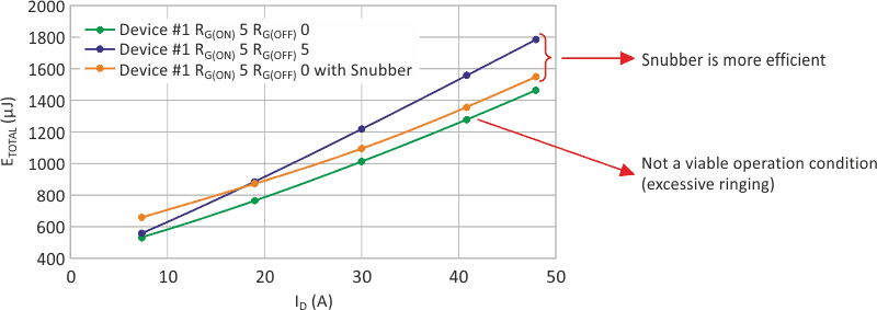

A better solution is a simple RC snubber. You might baulk at the idea of the large, hot resistor-capacitor network typically needed with IGBTs, but for SiC FETs, its different. It is used mainly to damp the resonance between connection inductance and device capacitance, which is extremely low with SiC FETs. This means that a capacitance of around 200 pF (2X or 3X of COSS(ER)) is all that is typically needed with a few ohms of series resistance to provide the damping. Some power is dissipated in the snubber resistor but the network acts to reduce overlap between switch-off voltage and current in both hard and soft-switched applications, so losses are actually less on this transition.
A snubber produces some dissipation on turn-on, so for a complete picture, total losses EON + EOFF should be considered. The Figure 1 shows ETOTAL for a 40-milliohm. The blue line is with no snubber and 5 ohms for both RG(ON) and RG(OFF). The orange line is with 5 ohms for RG(ON), zero ohms for RG(OFF) and with a 200 pF/10 ohms snubber. There is an obvious net benefit using the snubber at 40 A, of about 10.9 W reduced dissipation when operating at 40 kHz. At light loads the situation is reversed but dissipation is low at these levels.
The total losses vs. drain current.
Figure 1. The total losses vs. drain current.
A snubber is a great solution but is it an inconvenient overhead? If energy absorbed by a snubber resistor is evaluated in a typical application, it could be around 120 µJ per cycle, equating to over 5 W at 40 kHz. However, tests show that most of this is dissipated in the SiC FET channel as it transitions through its linear region at turn-on, rather than in the snubber resistor. The result is that a 1 W resistor is typically adequate in the snubber, which could easily be a surface mount type at this power level. The capacitor is small.
