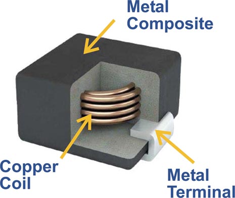

The metal composite core offers high current saturation characteristics that allow the inductors to maintain function with the large ripple currents typically found in modern power applications. High permeability enables low values of DC resistance (DCR) that result in significantly reduced self-heating during high current operation, thereby increasing system efficiency and reducing the need for thermal design considerations.
The METCOM inductors feature a shielded construction that contains the magnetic flux within the inductor body, increasing the efficiency of operation. This also improves EMI performance and eliminates interference with surrounding circuitry, significantly simplifying the task of gaining power supply approvals.
The design of the METCOM inductors
The design of the METCOM inductors.
