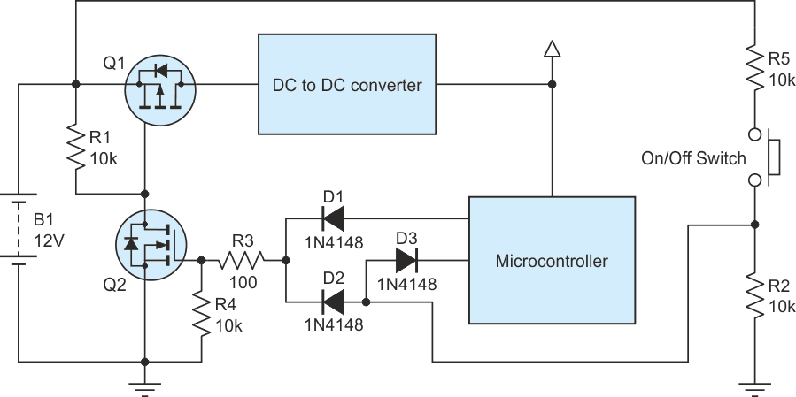

| Figure 1. | This is a common block based diagram, you should select the right components for the blocks according to your requirement. |
The circuit diagram of the power switch is shown in Figure 1.
Explanation
At first, when the circuit is connected to the battery, nothing will happen. Why? due to the R4 discharge resistor, the Q1 (P-Channel MOSFET) is off. Because the Q2 is not active. So the gate of Q1 will remain high. That is why Q1 will remain off. So? no current flow to the DC to DC converter block and so does the MCU.
Now, when you press the on/off switch, the N-Channel MOSFET Q2 will be turned on and so does the Q1. And whenever the Q1 is on, DC to DC converter (or regulator) will be on.
Now, you are getting your required power to start the microcontroller. And in the code, just set a pin high through which, you can turn on the MOSFET Q2.
If you can put this code on the starting, the MCU will hold the power line. So, if you release the on/off switch now, your circuit will be still on. And at any moment, you need to turn it off, simply push that button again and sense it with another pin of your MCU.
Then, set your code for shutting down. Do all the necessary tasks before shutdown and then simply set Low to that pin which was triggering Q2 through D1.
