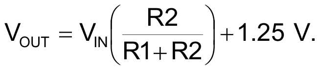

The circuit “reverses” the standard hookup of the LM317 adjustable regulator(Figure 3). Normally, the ADJ pin connects to a voltage divider on VOUT, and the LM317 regulates VOUT by keeping it 1.25 V above VADJ.
| Figure 3. | LM317-based capacitance multiplier. |
Here, VADJ is set to a filtered fraction of VIN. VOUT will be 1.25 V above VADJ:
If there’s ripple/noise on VIN, use the average voltage in the formula.
Note that the 317 has a 3 V dropout voltage, so VOUT must be lower than 3 V below the lowest voltage on VIN (including any ripple). Also keep in mind that VOUT’s minimum load is 10 mA; and that there can be up to 100 µA of bias current through the ADJ pin (sourced from VIN), so R1||R2 shouldn’t be too high.
