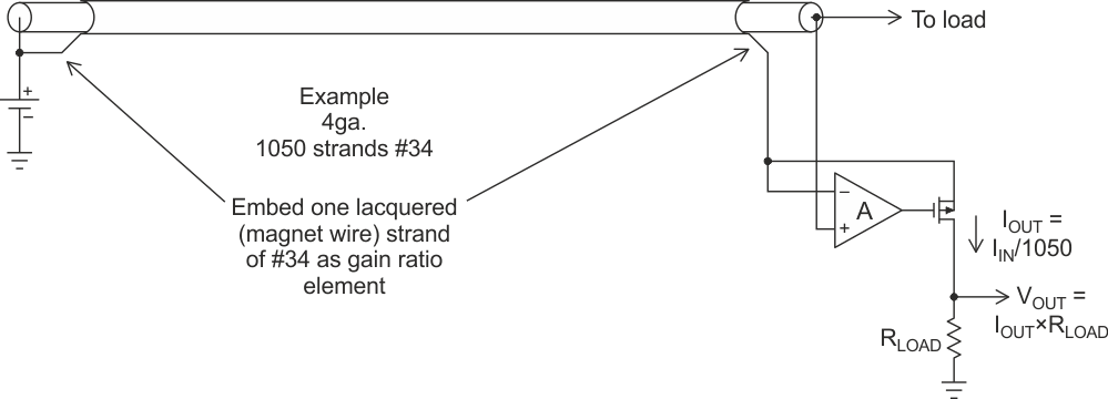

What remains is what to do about the tempco. The solution proposed in this Design Idea takes advantage of the fact that high current cables are made up of many fine strands. The example here will be based on AWG 4 cable with 1,050 strands of AWG 34 wire.
In Figure 1, the operational amplifier non-inverting input senses the cable drop on the load end of the cable. The MOSFET is in the output/feedback path, which continues through the temperature-sensing strand – what would normally be a resistor for setting gain – ending at the power supply. The circuit forces a drop across this gain-setting element which exactly equals the main cable drop. In this case of course, the gain-setting element is the single insulated strand (lacquered such as magnet wire) of 34 gauge wire embedded within a custom insulated cable assembly including the high current cable.
Temperature-compensated high current measurement using ratio'd cable.
Figure 1. Temperature-compensated high current measurement using ratio'd cable.
From (Ref. 1):
AWG 34 = 265.8 Ω/1,000 ft.
AWG 4 = 0.248 Ω/1,000 ft.
E.g., 0.474 ft. of #4 = 117.6 µΩ; 10 mV drop @ IIN = 85 A; IOUT = 80 mA
Since the cable is composed of 1,050 strands, this arrangement will cause a current to flow in the MOSFET and gain element which is proportional to the total current divided by 1,050. Because the gain element as well as the cable are both composed of copper, and are in intimate thermal contact, output variation over temperature is cancelled.
The feedback current flows out the MOSFET drain through RLOAD to ground, providing a ground-referred output voltage.

Our setup used four feet of JSC 1666 AWG 4 cable (Figure 2). The insulation was slit along its length, and 34 gauge magnet wire inserted under the insulation. An NCS333 op amp was used in the circuit. Since the op amp’s common-mode voltage is equal to its supply rail, it must have rail-to-rail input ability (or use a higher supply). Furthermore, it should be a zero-drift (chopper) amplifier, as standard rail-to-rail op amps have generally poor performance near the positive rail.

At a 10 A load, VOUT = 454.6 mV (5.85% error).
At a 58 A load, VOUT = 2.604 V (5.7% error).
This setup was then placed into a temperature chamber and tested from room up to 100 °C. It demonstrated less than 0.1% of additional error. Several factors can contribute to that error, such as op amp offset drift, as well as resistance and thermocouple effects in the terminations of the cable.
