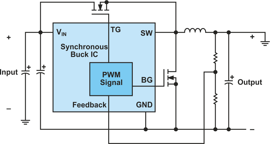

Designing an inverting buck-boost converter using a buck IC
A buck converter.
Figure 1. A buck converter.

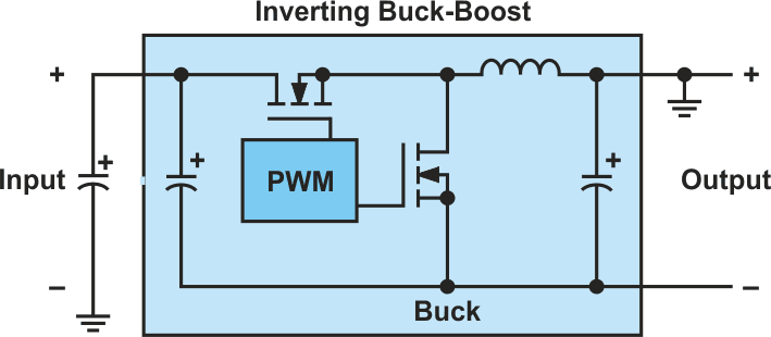

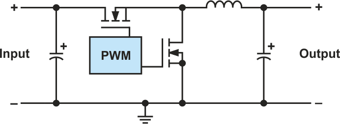

Figure 1 shows a simplified schematic diagram of a buck converter. It takes a positive input and outputs a positive output with a lower magnitude. Figure 2 shows an inverting buck-boost converter that takes a positive input and outputs a lower or higher negative magnitude. As seen in Figure 3, a buck topology can be converted to an inverting buck-boost topology by doing the following:
  • Converting the positive output of the buck converter to the system ground
  • Converting the system ground of the buck converter as the negative output node
  • Applying input voltage between the VIN and positive output of the buck converter
An inverting buck-boost converter.
Figure 2. An inverting buck-boost converter.
Converting a buck converter to an inverting buck-boost configuration.
Figure 3. Converting a buck converter to an inverting buck-boost configuration.

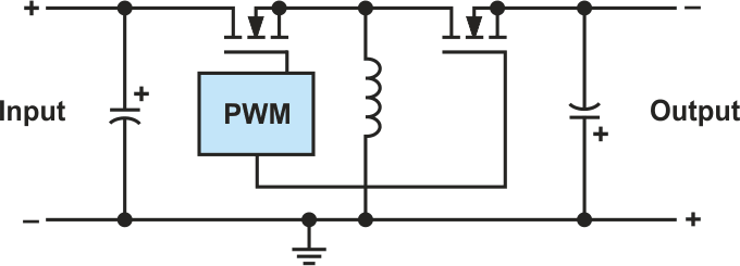

Figure 4 shows a simplified schematic on how to convert a buck IC to an inverting buck-boost configuration.
A buck IC used in an inverting buck-boost topology.
Figure 4. A buck IC used in an inverting buck-boost topology.

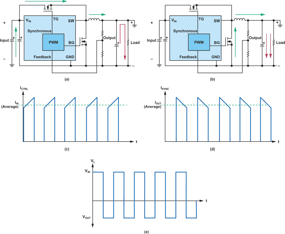

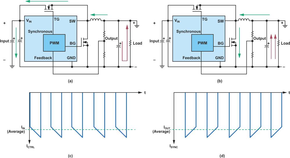

Sourcing current
Figure 5 shows the waveforms for an inverting buck-boost converter and the current flow when sourcing current. Figure 5a shows the current flow throughout the converter when the control MOSFET is turned on. Figure 5c shows the current flowing through the control MOSFET and its average is the input current. During this time, the inductor starts storing energy, ramping up the current while the output capacitor supplies the load. The inductor voltage is equal to the input voltage in this period.
When the control MOSFET is turned off, the sync MOSFET is turned on, and Figure 5b shows the current flow through it. The output current is the average current of the sync MOSFET, and the inductor voltage is equal to the output voltage. As the inductor supplies the load and capacitor, its current starts to go down. This will repeat every switching cycle.
(a) Current flow during on-time, (b) current flow during off-time, (c) the current through the top/control MOSFET (ICTR), (d) the current through the bot/sync MOSFET (ISYNC), and (e) inductor voltage.
Figure 5. (a) Current flow during on-time, (b) current flow during off-time, (c) the current through the top/control MOSFET (ICTR),
The feedback of the converter controls the pulse-width modulation (PWM) to regulate the output voltage to the desired level, which is set by the voltage divider resistors. Equation 1 shows the relationship between the output voltage and input voltage.

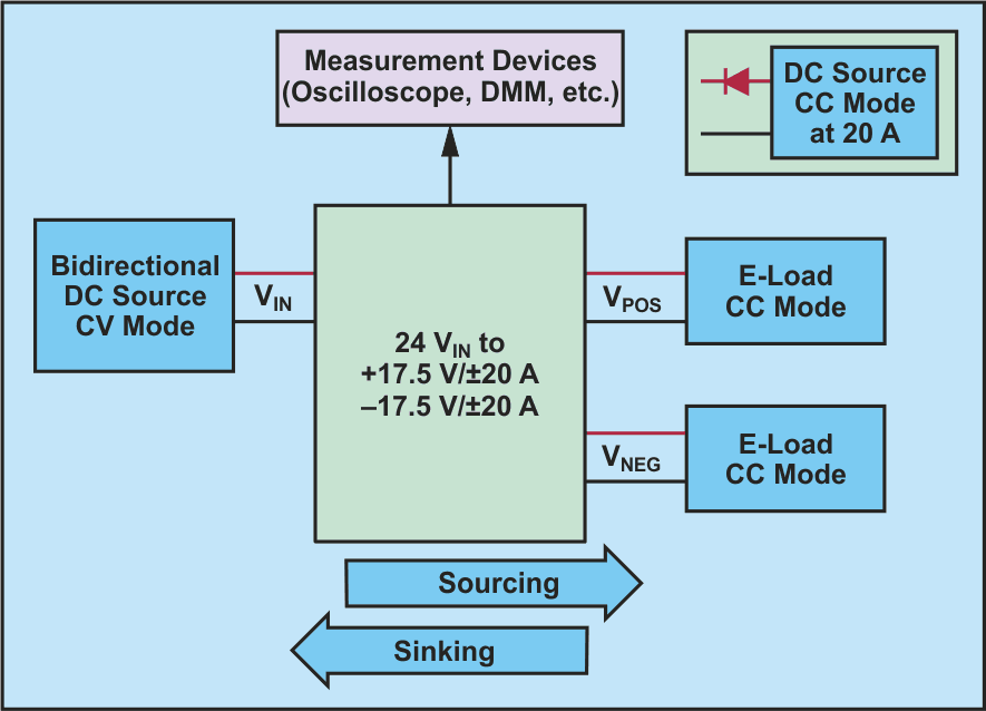

Figure 7 shows the actual test setup to test the source-sink and sink-source capability of the design. Figure 8 shows the block diagram of the setup. The bidirectional DC source acts as the supply of the VPOS and is in CV mode. The other DC source is connected to the output of the VNEG. This DC source controls the amount of current that is sunk into the system. A blocking diode is connected in series with this DC source to ensure that no current will flow into it when the converter is sourcing current. The e-load is used as the initial load to show that the system is capable of transitioning from sourcing to sinking and vice versa.
A block diagram for the setup.
Figure 8. A block diagram for the setup.

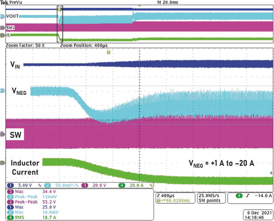

A VNEG source to sink transition (+1 A to -20 A).
Figure 9. A VNEG source to sink transition (+1 A to –20 A).
The waveforms captured are shown in Figure 9. When the DC supply is turned on, the VNEG rail starts to sink current. As seen in the inductor current waveform, it transitions from positive current to negative current. When the VNEG is sinking current, the system is open loop during this condition and the source-sink current is controlled by the CC mode of the external DC source. This is also true for the VPOS in Figure 10. When the DC source connected to its output is turned on, the VPOS rail starts to sink current.

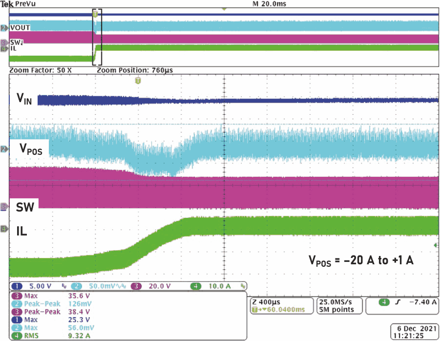

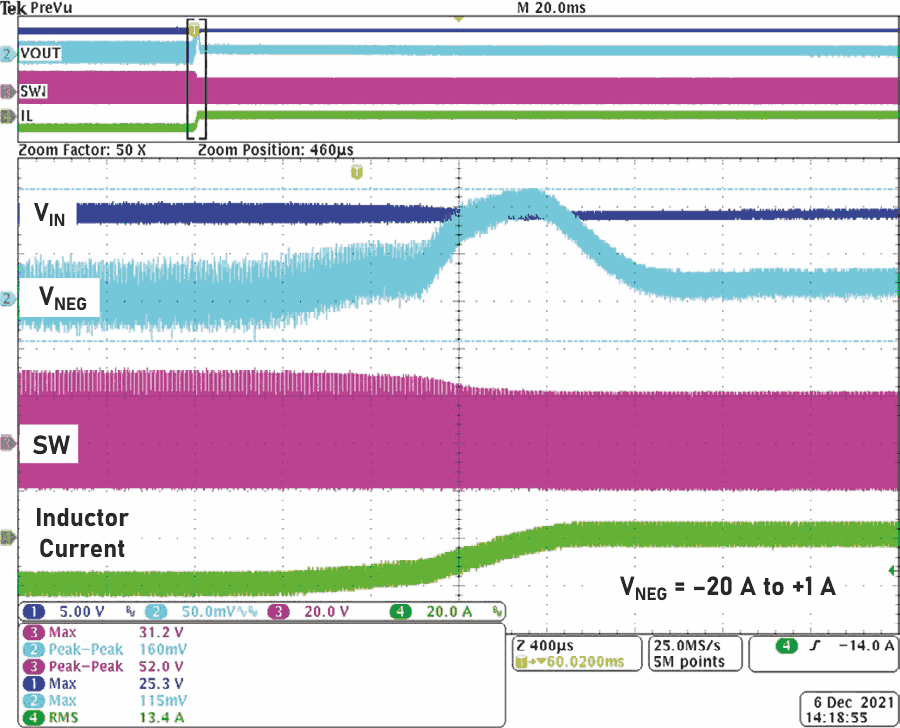

The waveforms captured and shown in Figure 11 are the source to sink transition behavior of the system. As seen in the inductor current, it transitions from negative current to positive current. This indicates the transition back to sourcing current when the injected DC voltage across the VNEG is removed. This is also true for the VPOS rail shown in Figure 12.
A VPOS sink to source transition (-20 A to +1 A).
Figure 12. A VPOS sink to source transition (–20 A to +1 A).
