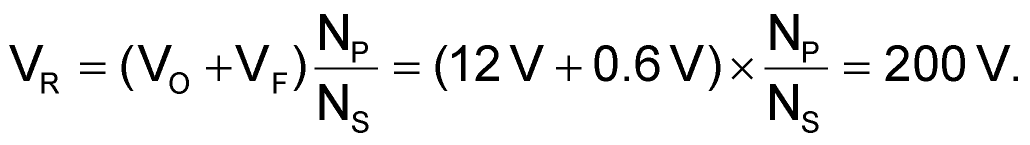

The reflected secondary voltage to the primary is
(Turns ratio is 16:1). Switching frequency = 100 kHz (T = 10 µs).

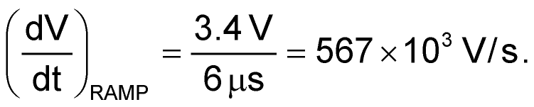

To get a fairly linear ramp, its maximum voltage can be selected to be 1/3 VCC; that is, if VCC = 12 V, a reasonable peak voltage is 4 V. Then the ramp amplitude is 4 V – 0.6 V = 3.4 V.
Calculate the maximum duty cycle:
The slope of the ramp:

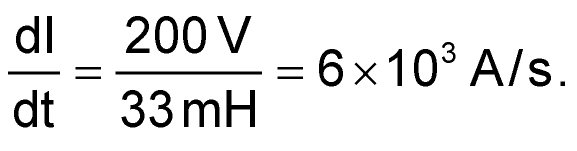

The down slope of the primary current:

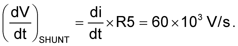

The slope of the voltage in R5:

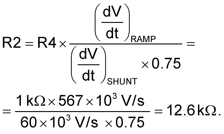

Calculate R2 for 75% slope compensation:

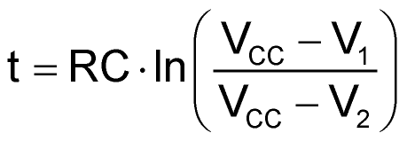

The next step is to find the values for R1 and C1, with R1 << R2. We have to use the charging capacitor equation:
to get suitable values for R1 and C1. In the example, t = 6 µs, VCC = 12 V, V1 = 0.6 V, V2 = 4 V, so the result is RC = 17 µs.
A good choice is C1 = 22 nF and R1 = 750 Ω.
