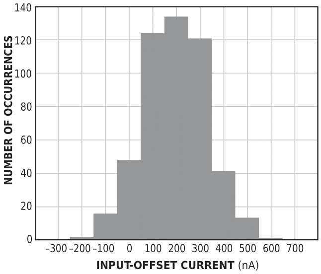

| Figure 2. | This bar graph shows the input offset-current distribution. |
Figure 2 shows simulation results of 500 Monte Carlo runs for IIDEAL = 10 µA, gain G = 1000, and VOUT = 1 V. The npn transistors have an emitter length of 40 microns and use a 0.35-micron silicon-germanium BiCMOS process, but you can use the simulation method for all current mirrors and all types of transistors. The average of the distribution in Figure 2 is 194 nA, and the standard deviation is 131 nA. The average is not zero because of the base-current error.
