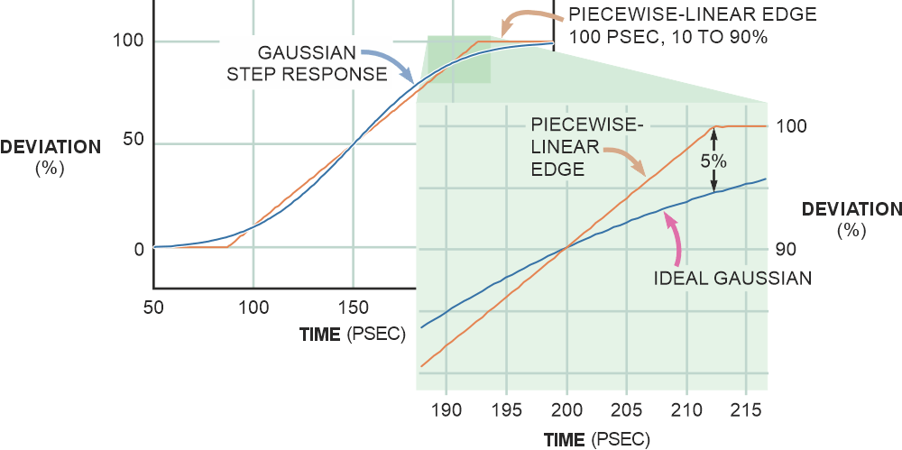

Which step in Figure 1 best approximates the digital signals you work with every day? The piecewise-linear step starts with a jerk, mindlessly follows a perfectly uniform ramp, and smacks hard into its upper limit. Real signals don’t do that. The smooth-looking curve is a Gaussian step. It is the time integral of a Gaussian bell-shaped curve. The Gaussian step has a smooth precursor, a smooth tail, and a fast, monotonic rise in the middle. It looks more like a real digital signal, and for a good reason.
| Figure 1. | The piecewise-linear step has sharp corners that do not occur in real signals. |
In the field of linear-system analysis, the Central Limit Theorem states that the step response of any system whose performance is limited by a large number of similar bandlimiting effects tends to become Gaussian as the number of effects approaches infinity. That theorem applies to digital devices because a typical digital driver comprises many performance-limiting stages cascaded in series, all having similar bandwidths.

You can see that the maximum time-domain deviation between a Gaussian step and a piecewise-linear step amounts to only 5% (Figure 1). That amount doesn’t sound like much, but those sharp corners in the piecewise-linear curve can induce frequency-domain deviations as large as 20 dB, a significant source of error.
