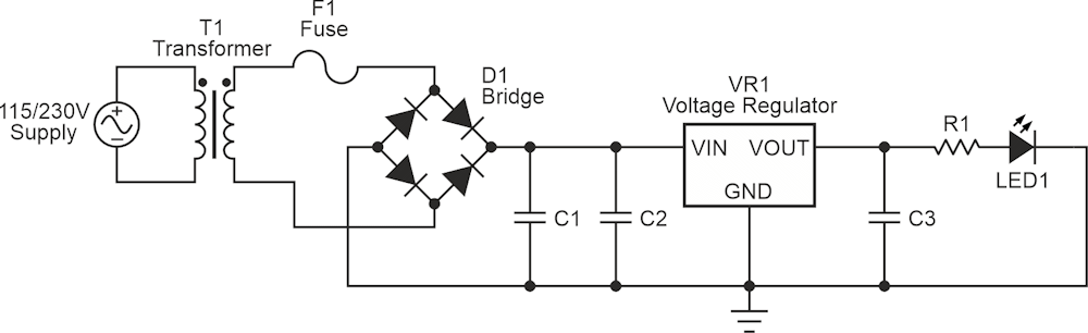

One obvious approach is to keep it simple and just draw a little power from any available DC rail in the product to provide around 20 mA to drive a red LED. If a suitable rail isn’t available, you could add a small circuit to drive that LED (Figure 1).
| Figure 1. | It’s not hard to drive an LED indicator from the AC line, but it requires many active and passive components. |

Even if that’s not a concern, the separate indicator circuit is relatively costly and complicated for what it does, even if the bill of materials (BOM) is small. If there isn’t a DC rail that you can tap and you do need a step-down transformer, or you need that transformer for regulatory-safety isolation, things are no longer simple and cheap.

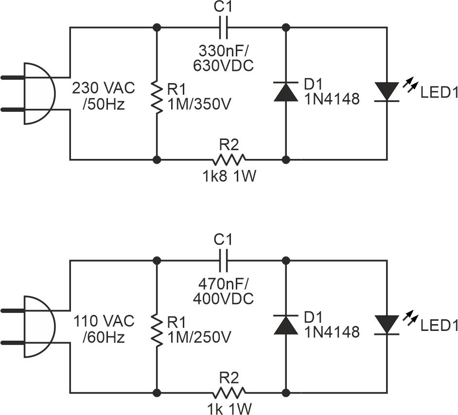

Another possibility is the “capacitor-dropper” (cap-drop) supply which is used in some commercial designs when a low-current DC rail is needed from an AC source (Figure 2).
Again, these circuits bring regulatory and safety concerns and issues and would have to be physically separated from other parts of the design. To meet safety codes such as those from UL, the entire circuit and its tiny circuit board (if any) must be arranged physically, so the user is protected if there is a fault to the chassis. Furthermore, this approach requires larger, more-costly, higher-voltage passive components, especially the capacitors, which must provide a safety margin of about twice the line-voltage peak.

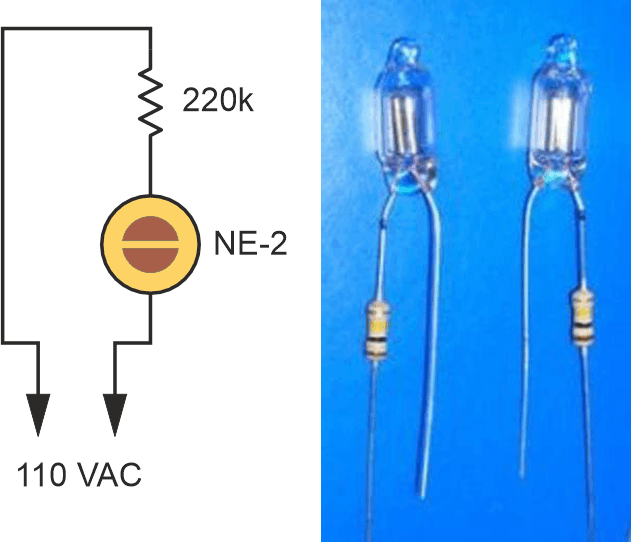

Fortunately, there is a time-tested and highly reliable solution: use a small neon bulb and current-limiting resistor, which can be connected directly to the AC line (115 or 230 VAC), as shown in Figure 3. While this circuit must also be properly insulated, it’s so simple and small that it can be covered in a single piece of heat-shrink tubing or a similarly insulated setup.
| Figure 3. | All it takes to use a neon lamp with an AC line as its power source is a current-limiting series resistor, as shown in the schematic (left); the physical implementation of the schematic diagram is also a simple interconnect (right). |
Neon bulbs – more properly called lamps, since that’s their function – have been around since the early 1900s and they come in a variety of sizes and styles. The most common size in general use for indicators by far is NE-2 lamp with a 12-mm length and 5-mm diameter (Figure 4).
| Figure 4. | The widely used NE-2 neon lamp measures about 12 mm in length and 5 mm in diameter. |
The value of the current-limiting resistor depends on the neon lamp size, desired brightness, and its minimum/maximum current ratings. This value is typically 50-to-220 kΩ for 120 VAC mains and twice that value for 220 VAC with an NE-2 neon lamp. The power rating for the resistor is also low, on the order of ¼ watt or less. It doesn’t get simpler than that – or more reliable.

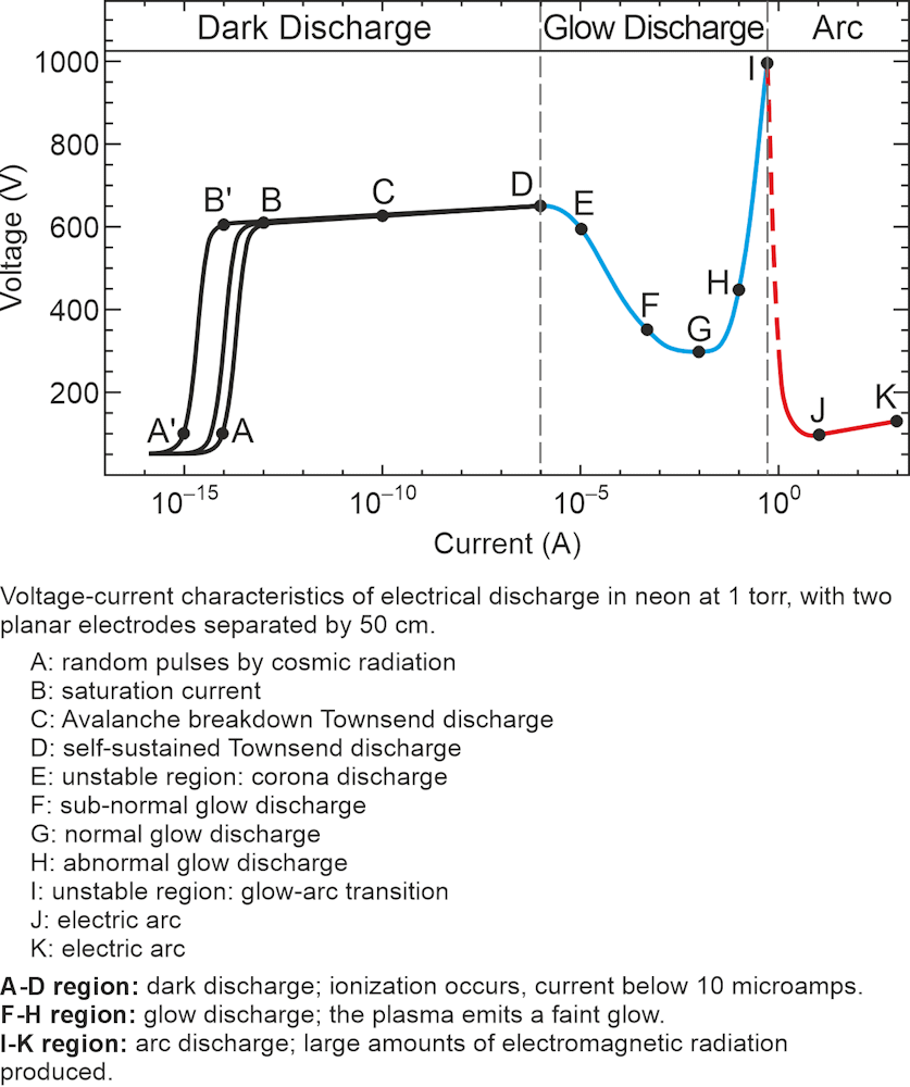

Physicists have studied the neon-discharge action in detail for over one-hundred years and have identified each of the phase transitions and associated reason for it (Figure 6).
The striking voltage is affected by the specific gas mixture and pressure in the lamp. Usually, the gas is a Penning mixture (named after Frans Michel Penning), which is 99% to 99.5% neon and 0.5% to 1.0% argon at a pressure of 1–20 torrs (0.13–2.67 kPa); this mixture has lower striking voltage than pure neon.
| Figure 6. | This detailed view of the three discharge zones shows some subtle effects and transition points. |
