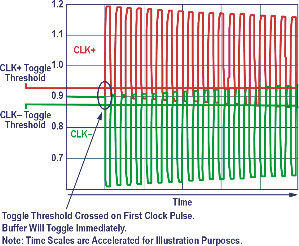

With no clock applied, CLK+ and CLK– will each be pulled to the same VCM by the internal biasing circuit in the clock buffer. When the clock is initially applied, the clock edges on CLK+ and CLK– will swing positively and negatively, or negatively and positively away from the previously established VCM. In Figure 1, VCM = 0.9 V.
Startup with CLK+ swinging positive on the first edge and CLK- swinging negative.
Figure 1. Startup with CLK+ swinging positive on the first edge and CLK– swinging negative.
Figure 1 shows the clock being applied after it has been inactive (either when first bringing up the system, or after the clock driver has been inactive for a period of time). In this case, CLK+ swings positive on the first edge and CLK– swings negative. With a positive offset added to the input toggle threshold, this clock signal will toggle the clock buffer on its first edge, as shown in Figure 1. The clock input buffer will produce a clock right away.
If perchance the clock was started with the opposite polarity, CLK– swings positive on the first edge and CLK+ swings negative. With the same positive offset added to the input toggle threshold, this clock signal will not toggle the clock buffer on its first edge and subsequent edges until the waveform is pulled toward steady state, and crosses the toggle threshold over time, as shown in Figure 2.

As can be seen, the polarity of the initial start-up clock makes a difference in toggling a clock buffer with input threshold offset. In one case (CLK+ initially rising in this example) the clock buffer will ideally start toggling immediately when the clock is first applied. With the opposite polarity (CLK+ initially falling in this example), the clock buffer will not start toggling immediately when the clock is first applied
If you are seeing an unexpected delay in ADC startup, try reversing the clock start-up polarity. This could make a difference in your start-up time.
